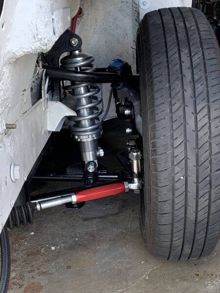

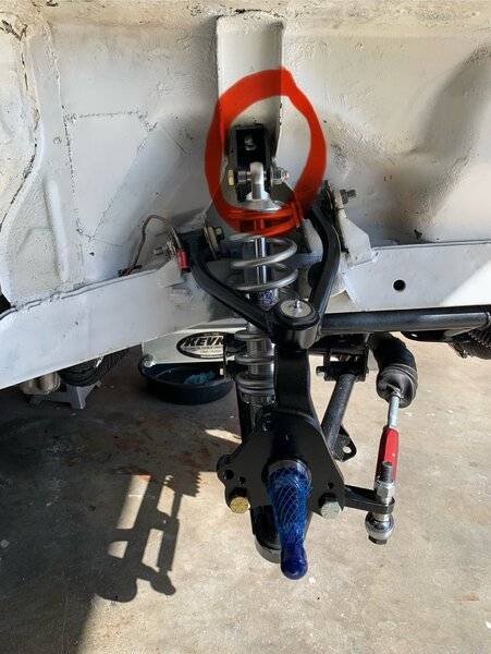

Do the countersunk screws and washers go through the shock bolt hole? What are the short support sleeves for?
Completely unrelated to your current discussion, but this photo makes it look like you have a ton of positive caster. Did you align the car yet?
Yes I did. It ended up with more positive caster than the previous alignment but I don’t have the numbers in front of me.Completely unrelated to your current discussion, but this photo makes it look like you have a ton of positive caster. Did you align the car yet?

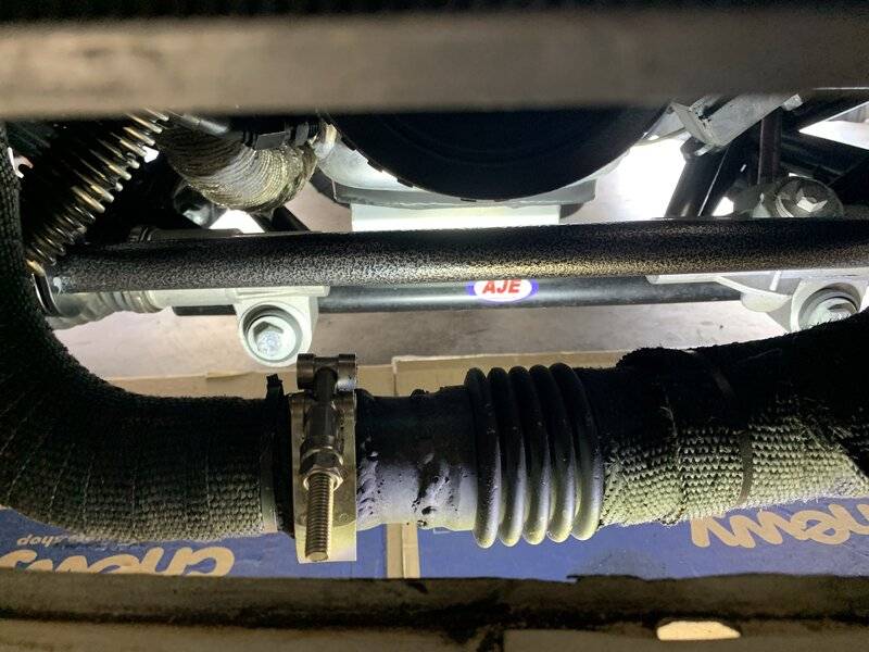

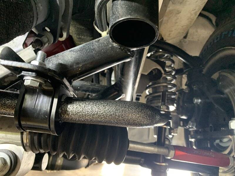

Race cars don’t need sway bars! Haha. JK always awesome when you don’t have to modify stuff to make it workAdded the Hellwig sway bar for a 73-76 A Body. Bolted up easy and luckily cleared my turbo hotside.

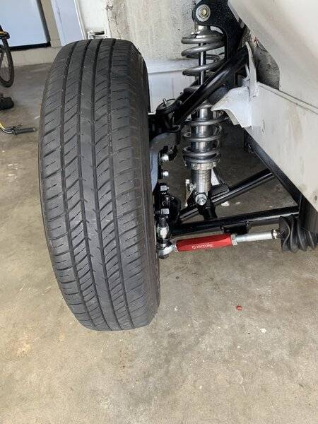

SteelNice setup are the steering arms steel or aluminum. Thanks
ThanksSteel
You should probably confirm with AJE. The suspension dimensions of my car are more narrow than yours so it may require a different anti sway bar.Hello friend, excellent project, a question, what part number of the sway bar did you put, since I am installing the same suspension on my 68 barracuda and the bar that I bought from qa1 is much larger, greetings from Mexico
Try this email:I sent an email to aAJE suspension and I didn't get a response, my problem is that I don't speak English to be able to make a call, a great favor, do you think you can help me contact aje suspension and see which sway bar I need, I will thank you very much
Gracias por el apoyo
How does this system feel on the street. Any bump steer or Ackerman concerns. Thanks love the car!
Drives great on the street. No issues.How does this system feel on the street. Any bump steer or Ackerman concerns. Thanks love the car!
Thanks for responseDrives great on the street. No issues.
Sorry to bother you again. What weight are the springs ? I have a 408 with single turbo like what you have. Thanks againThanks for response
Viking C210 Coilovers with 225lb springsSorry to bother you again. What weight are the springs ? I have a 408 with single turbo like what you have. Thanks again
What is the measurement of the bar from end to end and can you help me with the part number and where you bought it please?Added the Hellwig sway bar for a 73-76 A Body. Bolted up easy and luckily cleared my turbo hotside.
