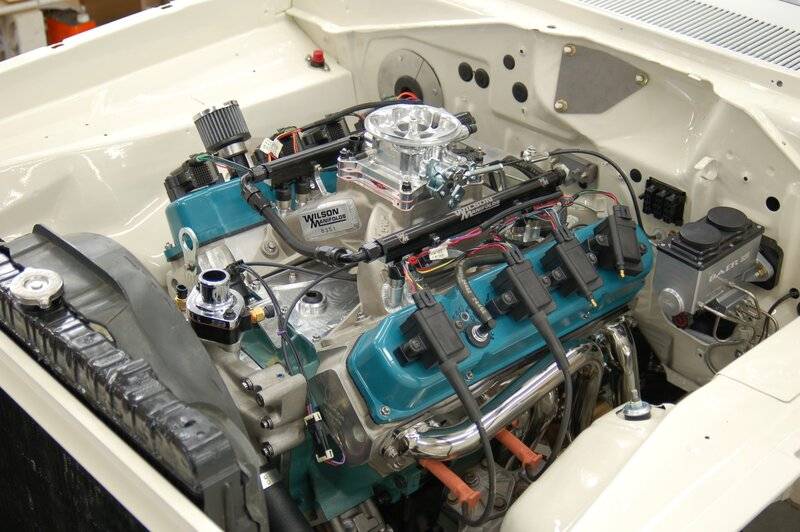

Right, I did my Duster up with the full meal deal including coil near plug, digital distributor, driveline speed sensor for traction control, digital dash, fuel trim by cylinder and ignition advance by cylinder. Lots and lots of knobs to adjust.

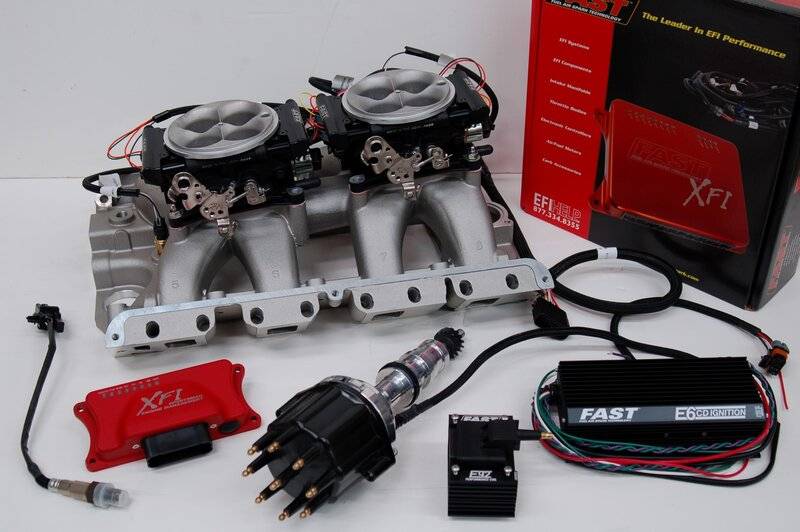

I tuned a 427 Ford with dual quad throttle bodies a few years back. It was a beast. It was for a street car so pump gas compression and a modest cam, but it still hammered out 700 hp at peak. Very impressive setup.
View attachment 1715661294 View attachment 1715661295 View attachment 1715661296
Andy, that is really badass, but it true Ford fashion, you should have mounted the throttle bodies backwards. lol
I did actually have some Ford guys try and tell me that the throttle bodies should be mounted backwards so I could use the factory throttle linkage. But I thought the factory throttle linkage was a dumb design so I got rid of that stuff and made a normal linkage kit and a high quality fuel log. Some of the original Ford stuff was rinky dink.
It probably was. A LOT of that stuff from the 60s was WAY more than wonky. It WORKED, but that's about all.
