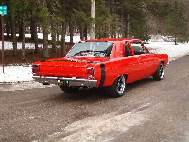

Holy Jeebus! That is exactly!!!! what I want my Valiant to sit like! Wheels, stance, everything is perfect! Man I need me some big wheels!!! NOW
gawd thats nice !!!
don't give me any crazy ideas, i've got too much blood and money into my valiant already.
yep, pauly was the one who influenced me as well! what a pain in the *** it has been trying to get the damn things to fit!!
i'm still gonna focus on the valiant.
