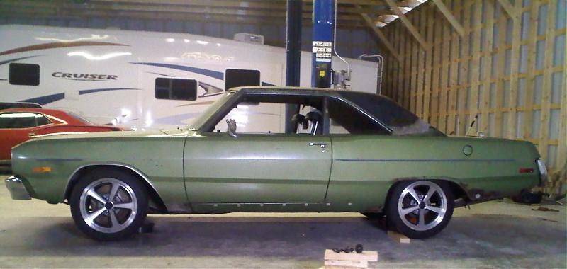

It WORKS!!!! I installed the new FF uppers today and EVERYTHING clears!!! I am able to reach full turn lock to lock without the rims interfering with the upper control arms!!! I also installed the B-body rear axle into my car, along with the new QA1 shocks! It looks good!! Time for an alignment! Here are some pics...
Here are some of the axle...
My new rebuilt B-body 8 3/4. It has new Green Bearings and seals from Doctor Diff. All new brake drums and shoes, new wheel cylinders and brake hardware, and new brake lines. Cleaned up the 742 pumpkin with 355 clutch type sure grip, and I moved the spring pads in 1/2".
Here it is on the ground, with my old 489 case open 294 8 3/4
Looks great! I have got to find a set of these wheels! The sticker on the rear-end is pure genius!Awesome!
what bill didnt come through?
No, he did...But BEFORE he told me, I already ordered the ones from firm feel...Then a week later after I ordered them, Bill emails me saying he's gonna make a new set for me to try out...So, I got the Firm Feel units in the mail, and thought I'd give them a try. I don't know how much longer I have to wait for the ones from Bill, so, I put these ones on...I'm guessing a week or so at least for the arms from bill... Now I'm stuck with an extra set of tubular uppers...if I have no luck in returning them, I'll put 'em up for sale for $15 less than what they go for...If that's fair...
