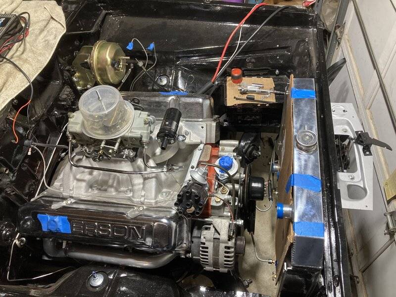

I even did this on a slant six that was crazy hard to start and would idle like crap. This slant has 4 barrel and an agressive cam ( installed in 1991 cant rember the specs anymore) Once i upped the timing to I think either 10 or 12 degrees ( its been awhile) put the plate in it starts after a few cranks and never stalls anymore.
