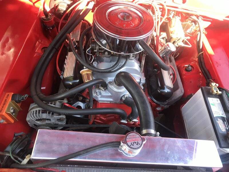

What is the best choice all around Carter 4-barrel carb for a stock 66 273 with stock exhaust manifolds and an Edelbrock LD4B intake manifold?
Thanks in advance.
I would focus on a Performer 500 or AVS2 500, either with electric choke. The choke can be adjusted to barely come on or backed right of. Even on a Commando it will give snappy performance.
On a Commando engine, the AVS2 650 will provide more power.
All around performance on a stock 273, chose the AVS2 500. The overall performance and fuel economy will be better than a larger carb.
If you are keeping the "2-barrel, stock cam", a 500 cfm carb will give good response and better mileage. If you think you may need to change carb jets, then get one with easily replaced jets. If it is an automatic, you probably won't use the secondaries very often.
Are you going to give it an exhaust system that will let it exhale better?
Make sure the timing is optimal; you can develope your own advance curve with a dial-back timing light and a plot of a few points with just mechanical and with vacuum advances. Compare that to curves for a factory, 4-barrel engine and you will be able to see if you have the distributor set up correctly. Tuning is critical to get a properly running engine.
Well I don't know how popular this will be but I used a quadrajet. It sits on a cast intake. Jets are easily dialed in. Has electric choke. Had to use lil imagination for kickdown but the 67 cuda w/273 runs great and when the 4bbl opens up it's got that mean air rush noise.
