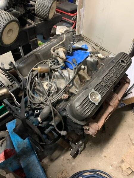

I recently bought a 318 shortblock and i had a chance to buy a complete engine , 1979 LRE truck eh1 known as the e58 package too...i heard that the 1979 version lost the "340" cam , so i wanted to upgrade it lightly , ldb4 intake and thermoquad and going in my 4 speed cuda....whats the limits of a stock J #596 head with 8.4:1 compression and 410. Camshaft engine , ive seen summit cams , 340 replacement cams and lunati cams , im on a very thight budget and advancing slowly with my cuda but i had no engine and now i have the 318 , 360 , speed and 2.76 gears ( going for 3.23s )**** overall best street cam for a stock 1979 360 , any dynos or real life experience ?
The EH1 was not an E58. It was a modified E58.
The EH1 only came out in the LRE. It had a bigger carb than the E58 engines.
Where is it written that the 79 LRE used a differant cam? What about the 1980 LRE's that went to Canada?
