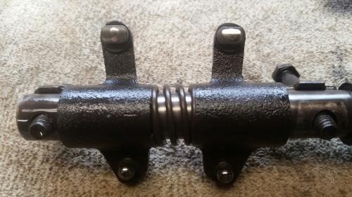

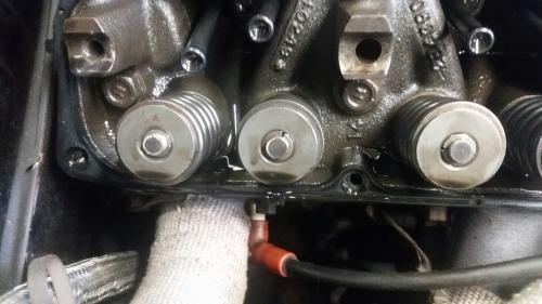

Took off rocker assembly to investigate. Oil to all parts,Push rods all straight, rockers,springs seem fine
except #8 intake rocker wear (see photos) and #8 exhaust valve wear??
Before I proceed wanted some input on possible problem? Bent valve? Valve guide?

I would pull the spring and make sure nothing is broken there. Did you measure lift at the lifter? Any chance the lobe is going away? Leak down test will tell you if valve is bent.
pushrods look pretty good, might be photo along with oil distorting Pic.
slide the 2 cylinder #8 rockers off and inspect. how big was the lash? a worn lobe is smaller=less load on the valve and spring. something is worn wrong, better go safe than sorry. look for broken springs

Just throwing some other simple stuff out there. How's the end of that shaft look under the rockers? Is it still round when torqued down? Flatness across all rocker posts good? Consistency of rocker tip wear across the bank?
All rockers, no play on shaft and spin around freely with no bind.

EZ enough to pull that valve spring and rotate the valve, see if the stem is bent or valve binds on the seat. The rattling may be the valve sticking in the guide, and the increased wear on the rocker could be part of that issue.

Watch the fourth valve stem from the rear, either it, or the rocker is moving laterally, and appears intermittant as well.
Put a screwdriver between the valve springs and move retainers sideways, and back and forth.
There's definately something screwy there and a coupla valves ahead of it too.

will move springs/ retainers 180 degrees
on cylinder 6/8.

I found #6 ex. rocker is not being pushed back on shaft to spacer by spring cause it is hitting part of head stock?
Can I grind part of rocker or shim entire shaft up and readjust lash on entire bank?
Or is that not something that could be the culprit of noise?
thanks D
