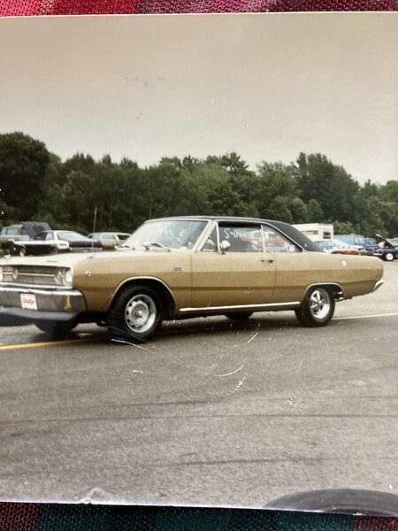

BEAUTIFUL Dart, by the way!

Ouch.
Thanks! its been an almost 40 year labor of love! ( bought it in 1982) with 7 different small block combos based on a.... 318 ( 12.60s best ...360 head ) 340 ( 10.70s...W2 head, 12 1/2 to 1 comp. 627 lift roller cam ) and (11.30s .."J" head 9 1/2 to 1 comp. 557 lift purple shaft mech. cam) 360 ( 10.40 best ...W2 head 11 1/2 to 1 comp. 590 lift mech. cam) and 408 ( 10.69 best ...R 3 block , Indy head , 9.8 to 1 comp. 600 lift mech. cam ) present is my back up 367 .. 360 Magnum block 40 over ...10 to 1 comp. W2 head , 585 / 594 lift mech.cam went 11.09 so far... picture from 1984 ran 15s with a mostly stock 318
