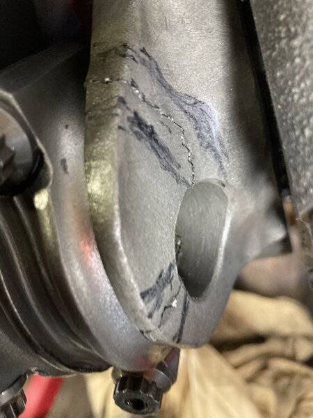

600 hp is very conservative, my 9.5 to 1 comp. 4 inch stroke 408 , R3 block, Indy 360-1 heads, 600 lift mechanical cam made 539 hp / 502 tq , very mild to run pump gas, ran 10.69 in my 3,150 lb. Dart it ran good until the crank cracked luckily nothing else got hurt, it has the potential for tons more power with a roller cam , more compression , and some head porting. There is an acquaintance of mine that has a small block Mopar that is around 950 hp.

And I am obviously not happy about it after only about 200 runs.. luckily it only took out the front main bearing and nothing else even the rod bearing by the crack still looked good.. Thank goodness it didn't hurt the precious " R " block... I haven't decided what I am going to do fix it, part it out or sell whole.
I'm curious how you found the cracked crank before it disassembled itself. Was it a main bearing knocking noise, or loss of oil pressure, or something else.?
I was at an Index race in Pa. Labor Day Weekend after being 008 and 012 on the pro tree ( figures ! ) second time shot I heard a vibration and lost oil pressure , not knowing what it was I just parked it, brought it home took it out and dropped the pan starting in the rear I started checking bearings they all looked good ( mains and rod ) until I got to the front and found the bad bearing then I saw the crack .. at least the bearing didn't weld itself to the crank or block it came right out. I knew something wasn't right when I could wiggle the balancer around. My " Mopar Mentor " says the vibration from the cracked crank is what took out the bearing.
If you put it back together, I would recommend a molnar crank, or at least a scat.
Eagle doesn't have a great reputation in my circles, but I guess that is a little late, hunh?
All in all, It could have been a lot worse!
AT least you noticed it and parked it before tearing up more expensive parts.
You both are so right !!! if I would have hurt the "R ' block I would have been real upset!!! as I said I am still looking at what to do with the motor, I already have another motor in the car I just had done I dont know if I can afford the luxury of having two motors so the 408 might go up for sale. I have a lot of $ tied up in it... R 3 block, Indy 360-1 heads and intake etc.
