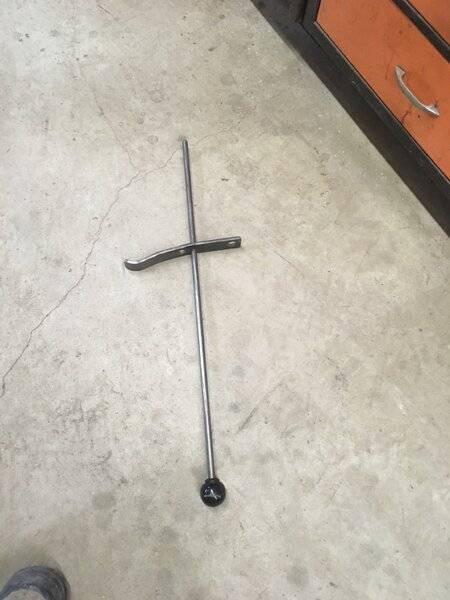

when i bleed brakes, i use a pedal depressor and do it myself. One pump,lock pedal down and open bleeder

when i bleed brakes, i use a pedal depressor and do it myself. One pump,lock pedal down and open bleeder View attachment 1715635306

That pedal depressor is nice, I've used my syringe bleeder before and it worked pretty well. I've also gravity bled my brakes before as well, the only problem with that is the rears barely gravity bleed at all.

3/8” round bar,steel platd with a 3/8 hole. Knob is to push on. wedge plate against front of seat. Easy.
