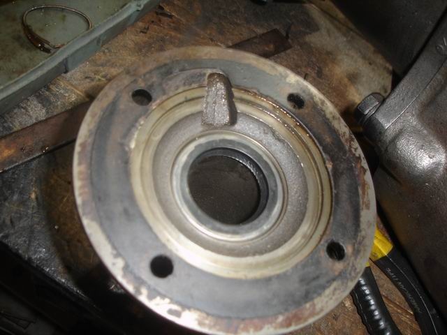

This buildup is insane, and i want to tell you in this picture of the installed front trany seal you did it wrong buddy this seal is installed backwards, just trying to save you some headeches my friend!
attachment.php
Hi thanks for your message.. unfortunatly I notice that I installed it backwards toooo late.. Had a lot of work to remove gearbox...
When I installed it I was too busy and confused.. later I told to a friend that I was confused and asked him to see this photo... lots of things do in a small amount of time... **** happens! =P~=P~=P~=P~=P~
attachment.php
nice catch,, any pics of how it should look?? cant rememebr how it looks even tho ive done my own,,
Hi
"DI" side must point to the oil side.. As we want to seal the gearbox, "DI" must point to the gearbox and "DE" to the engine.
As you can see, I installed it just the oposite. I was having a bad day and didn't notice it.
