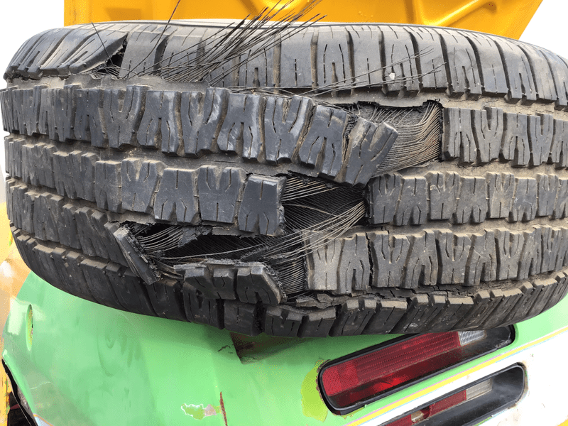

Any of you guys riding on tires over 6-7 years old. Please keep it under 50 mph unless you like to do bodywork.
They may look good but high rpms on an old tires will take the tread right off. Its whats inside the tire that counts. Not how many cracks you can see.
Just 40+ years of tire experience and thousands of separated tires that I have seen. All brands. All tires have the same construction just different tread patterns and rubber compound differences.
Check your tires DOT number if the last 4 numbers are older than 0916 , like 0816, 0716 etc. keep it i the neighborhood or get a new set to be safe for not just you but anyone who is driving near you.

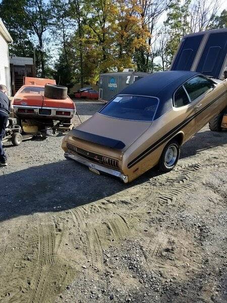

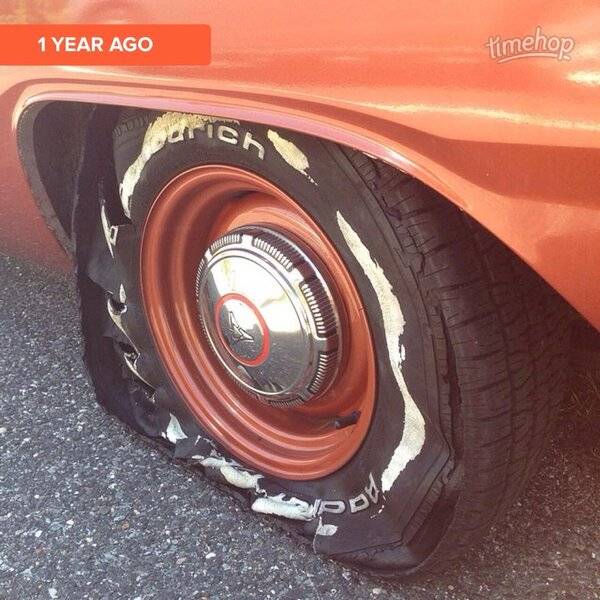

10 year old tire.. i didn't realize it was so old at the time.. i should have paid attention to the date codes on it. tire looked brand bew, nr scuffs or anything.. blew out on the garden state parkway going 70 mph or so.. i just put new tires on the dart.. the tire guy thought i was nutc because the kuhmo's on it looked brand new but they were from 2015ish.. i wasn't taking a chance with tire that old... some kid bought them cheap as hell to beat on..

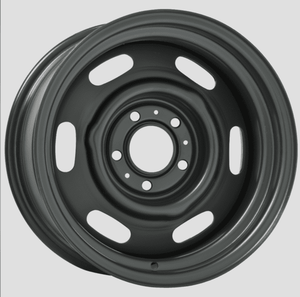

I'm a huge proponent of Steelies and dog dishes.. I use all General tires now. I've ran both the Firestone and the BFG's in raised white letter. The generals are superior in ride quality, handling and longevity.

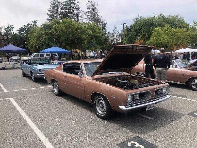

Both are 4 spd. Cuda has Cooper 275's. Demon had BFGs when it was purchased. Our road out front is a launch pad. The Coopers lay down black rubber marks that stick and last. The BFG's lay down powder you can sweep up. Unless you get them Sizzling with smoke then the marks last until the next rain storm. But the BFG's will do wheelies in the dirt. LOL.
The only reason to buy BFG's is for the cool looking white letters and the wheelies. First set of coopers we had and I like them. Usually run Hoosier Quick Time Pros .
