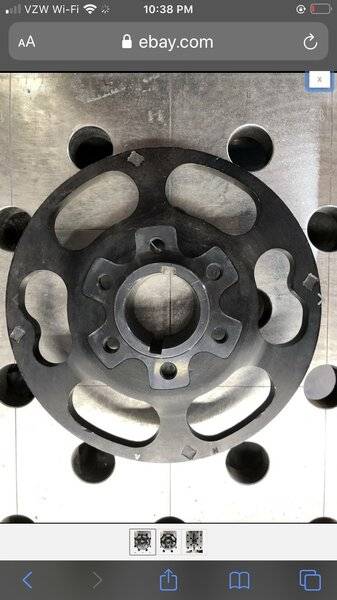

Sorry to hijack this thread Jack bit do you or anyone know of a company that makes a small block crank hub?
I only ever see Big block crank hubs.

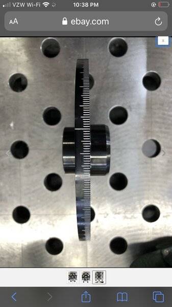

About the cheapest thing to replace, good 'bad' news! Fluidamper may throw the pulley alignment off, just an FYI.
Found a pic of my first gen fluid type CAT damper and its depth compared to a stocker and a "Pro-Race" with removeable weight. Later fluid type dampers had a recessed pulley face for better fit.
