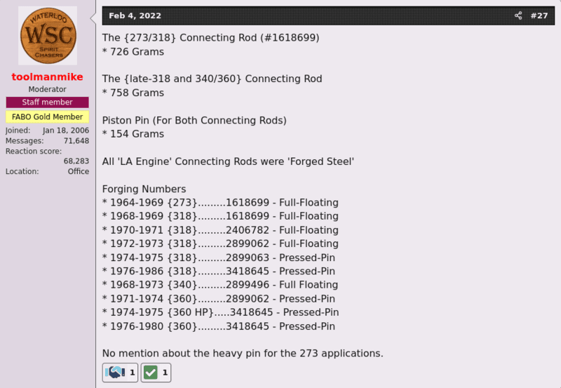

Another thing about building the 1969 318, 9.2:1 cr 230 HP engine is the fact that they have the "Free Floating Rods" that are 32 Grams lighter that the common heavier press fit 645 rods.
Saves a lot of effort and more accurate than trying to lighten up the 645 rods by grinding.
Check out this weight comparison posted by ToolManMike back in Feb. 2022:
'68 - '69 318 used the 1618699 (699) full floating rods.
'70 - '71 318 used the 2406782 (782) full floating rods.
My friend John of Talljohnsfunshop just did a vid about the rods... and using a high quality scale..shows a 40 gram diff between 273 floaters and 340 floaters.
