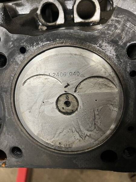

Well I’m guessing these aren’t KB167s like the now folklore surrounding this engine once suggested. I’ve done some searching but the eyebrows and centre relief doesn’t match anything…

Sealed Power. Good slugs. They look real close to zero deck.Well I’m guessing these aren’t KB167s like the now folklore surrounding this engine once suggested. I’ve done some searching but the eyebrows and centre relief doesn’t match anything…
Well that’s nice to knowSealed Power. Good slugs. They look real close to zero deck.

anyway, onto what you've got cooking. if you're not looking to spend a ton of dough or re-engineer the whole enchartio, i'd say you probably have enough cam to get there. those sealed power slugs aren't a bazillion miles in the hole and are up to the task.

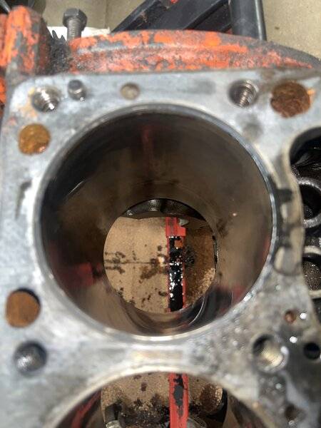

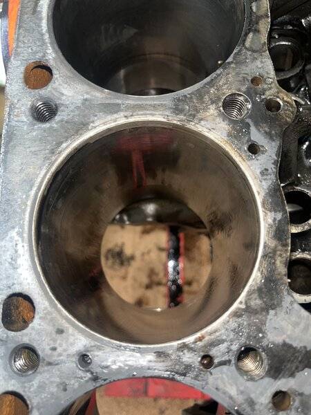

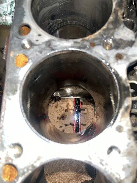

Flipped the block and pulled #1 piston and rod this evening, noticed the big end and the big end bearings are pretty scratched up, the crank is also .010 undersized. Rods are the usual 318 items the part no. now escapes me but there have been plenty of posts discussing them (not bushed at the little end). The crank has been ground, I can’t find any numbers of meaning, 616 on the end of a counterweight, 5389 on the side of the counterweight at the balancer end but nothing else.
This has given me some uncertainty and perhaps increased the shopping list.
Hopefully tmw I’ll get the remainder out and have a good look at the bores.

if you can get away with a polish, then i'd just slam bearings in and ship it. but if it's beyond that or needs another cut, then it's decision time. i can't wholly make a recommendation because i don't know what availability is like over yonder, but if you've got a crank requiring work and those bores hold unexpected surprises then it may be time to rethink the path forward, especially with the block already being 40 over.
babies n' bath water n' all that.
that's just the way the scone crumbles homie. set out to do it one way and the script gets flipped on ya. we fully expect an update on the bores and i look forward to help spending your money for you!
