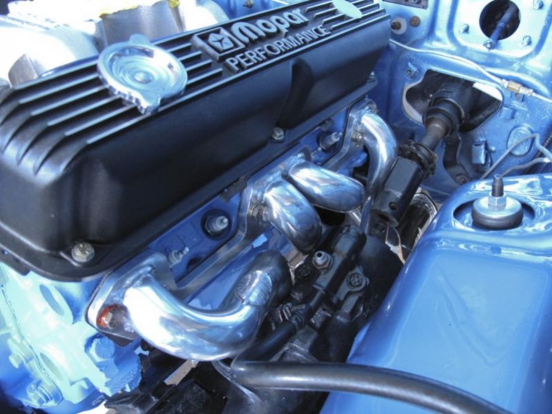

Anyone out there have experience installing Dougs on a 72-73 A body? I am building a 73 Dart but used my K-member, engine and drive-train out of my 72. Right around the power steering is where I'm having a "snag". Please note this is my first set of headers.. ever. Thanks!

Are you SURE your motor mounts are adjusted right? I had a 65 Valiant with the same headers and P/S and mine fell in and worked great. You might try loosening the mount bolts ane prying the engine over a little.
Mine was like that at first, then I shimmed the PS pump on the 2 inboard bolts and it was a little better, about 1/8". When I put in new mounts and a different engine, I suddenly had almost 1/4"
I actually had them in wrong when I initially installed the drivetrain. How I found out was my transmount was off by 2". Once I got the motor mounts right everything lined right up.
On the header install I've loosened both motor mounts and have tried shifting the motor left to right, also tried some shims on the power steering side. Seems like the issue is only on the first tube and only on a small area. Just not sure if I'm supposed to shimmy the pipe to fit? Seems odd considering how expensive these headers were.
Have you loosened the motor mount bracket on the engine itself and tried to get some movement there? Not just at the mounts at the K frame.
StrokerScamp I didn't realize I could get movement at the motor bracket side of the mount. Honestly I'd rather not have to ping these babies if I don't have to!

I went back today and loosened up the motor mounts and tried shifting the motor around. This time around I used my engine hoist for support (much easier). However I still found there was simply no room around the PS.
As much as I hated it, I marked off the section that was rubbing and took a pein hammer to it. Then removed the headers and repeated the process a few times until I noticed enough clearance. I decided to have the drivers side header re-ceramic coated for a better finished look. Once I get it back I'll post more pics.

I bet you have B/E body engine brackets, not A body. Or the brackets are on the wrong side of your engine. They move the engine forward and that is the issue you appear to have had.
The biscuit stud appears to be located in the rear half of the mount brackets, A's are in the front half when looking down from the top. You can see the bolt/stud in this pic which was the first tip.
attachment.php
The top of your pass side valve cover should be about 3" from the firewall. If it's about 4-5", = wrong motor brackets or wrong side.
Someone else had this exact issue and they got the right engine brackets, all was good. I'll say this.... IT'S NOT THE HEADERS!
I bet you have B/E body engine brackets, not A body. They move the engine forward and that is the issue you appear to have had.
The bolts appear to be located in the rear half of the mount brackets, A's are in the front half when looking down from the top. You can see the bolt/stud in this pic which was the first tip.
attachment.php
The top of your pass side valve cover should be about 3" from the firewall. If it's about 4-5", = wrong motor brackets.

I updated my post, I believe the brackets are on the wrong sides, pushing the holes rearward/engine forward. Swap the brackets side to side and he's in good shape except the headers have been clearanced already... damn those are rough now.
All the holes for mounts orient to the front. If the trans mount stud is to the rear, it's on backwards, should be towards the front and the x-member should slide up fairly easy when correct with hole in x-member to the front as well, to the rear, it's on wrong..
