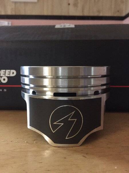

So what if I jump up more compression via the piston itself if I have clearance I can get away with another point say these KB190
Let first figure out what head you want to run and then run some numbers on a couple of different pistons and head gasket combo’s.
The heads are purchased the cam is also purchased so that's all in already.
COMP Cams K20-602-4 COMP Cams Thumpr Hydraulic Flat Tappet Cam and Lifter Kits | Summit Racing Mopar Chrysler SB 318 360 170cc 65cc Hydraulic Roller Assembled Cylinder Heads purchased carburetor is a pro-form 850 Holley 4150 quick fuel style. Intake is a Mopar Chrysler Dodge SB 318 340 360 MidRise Air Intake Manifold Machine Polished. Also have a 1.6 ratio roller rocker assembly brand new from speed master. I have not purchased the gasket set, pistons and bearings yet and freeze plugs.
My bad! Sorry.
If it were I, I’d use a flat top at zero deck. Like a KB-107 or similar. Also a .039 head gasket. That’ll work great with the aluminum heads and pump gas with that cam.
My bad! Sorry.
And that was my plan all along it's right on the edge 10.5 and 10.7 with 93 octane.other option or these pistons DODGE Speed Pro H116CP 30 Speed-Pro Hypereutectic Pistons | Summit Racing. I do appreciate all jumping in on this why I made the thread it's a great learning experience what I thought I knew. What I now understand more so. I'm in good shape for what I wanted is my conclusion.
I used those very slugs in the wife’s .030-360.
All my parts of except pistons are dropped off now. Hopefully week or two get my go ahead to order pistons I think my order the 30 over it was a running engine with no issues. Hopefully I don't regret that.

On the engine front was told they are getting it all cleaned up. He wants to check before I order pistons I'm pissed I should have just ordered them missed all the sales will get shafted on price now. I may just go ahead and pull trigger on my 30 over hell of the block is that bad I may replace see no issue with that compression checks were great and even. Only bad part was lack of oil changes as seen by distributor and Cam when I took a peak inside it.
Little stuck on piston choice I dont want a hyperkinetic piston now. Builders really hate on them for breaking and I'm concerned as they were pretty vocal and it was multiple folks. I know a lot here use them but I'm going to error on caution regarding my kb107 and not buy. I need a stock weight piston forged if possible flattop valve relief. The ones I have seen look like I will have to rebalance and do a new converter and such for the combo. It's also about the fact it's my motor and I want to do it my way my choices if that makes any sense. Any suggestions on the piston choice still waiting to hear back on overbore and how much I may have to go.
From what I've read, a big reason people have problems with the KB hypers is they don't follow KB's requirements for ring gap. If you don't follow KB's recommendation, the top ring ends will but when the engine gets hot, the ring sticks in the bore, and then bang the top land on the piston breaks. Set the ring gap to what KB says and you shouldn't have any problems. That said, a nice set of Mahle's with rings is only about $100 more than a set of the KB 107's and a set of Total Seal gapless...
As for balancing, it's about $300 which might sound like a lot but isn't really a lot considering how much you pobably already have in the engine.

Talked to builder going to get some pictures today. Number 3 cylinder was marginal may have to vote more than .30 over. They got it soaking in the vat cleaning up then will throw the bore bar on it see where we're at.
Dropping pistons off KB 107 30 over Monday will talk to him about decking block I'm not doing zero deck but I am going to get a bit more pressure and of course I want the block straight as well. He is afraid a bit because its close to 11 to 1. I should without decking be at 10.5 to 1 with a .039 felpro head gasket. So I got little to play with. Run premium no ethanol anyways. Have to make sure timing is dead on is the plan here.

I wouldn't push the compression on a KB piston...they reflect heat back at the chamber, so 9.5:1 acts more like 9.8-9.9:1 compression...
