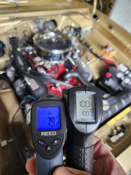

What's the IR say here?
Factory gauge is for looks only, it's unhooked.
There were a couple of postings a while ago about the validity of the IR readings due to heat soaking in the engine compartment. What leads you to believe that the Autometer temp gauge isn't working? Is your factory gauge still reading Ok?
Looks like my gauge is AFU. Drove car to work and brought my shitty CT gun to compare with a Reed temp gun. Shot them both at intake right by sender. Phewww!
Good reason why I do not use IR guns in confined spaces....or where there can be more than source producing heat.
The Reed gun(and my AM gauge) is correct. I also double checked pointing both at the floor. 25* difference there as well. Can Tire gun is junk, or maybe low battery caused it.
