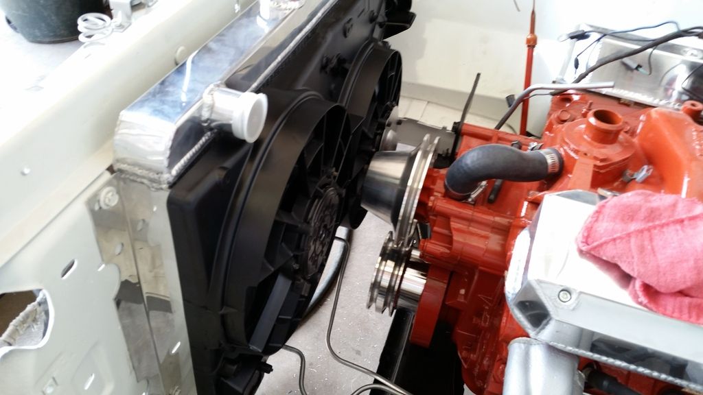

Looks like it's been done by kybatman. Hangs over the side a bit. If you have the open spots on the side, it will still work...doesn't look too awesome to me, but it's totally up to you.
On whether to have a mechanical fan vs electric fan...The electric fan, especially one with two motors is plenty reliable. Considering basically every FWD car has had one forever, and what's the failure rate (I've never touched one or known anyone who did), I'm not sure why you'd be worried about that. I have, however replaced a radiator, fan shroud and timing cover due to a bad fan clutch.
The contour one has bigtime flow. On my car the high speed has NEVER come on, it doesn't even heat up enough for that. If you flip it on manually (I use the A/C trigger), the car cools WAY down very fast. It's also usually never on when I'm moving above 10 mph and therefore robs 0 HP. If the fan was on at high speed and drawing even 40A, which I doubt it does, it would rob less than 2hp. I have yet to see a mechanical fan that can do that. And yes, your A/C will work better.
I think I looked it up right and the fan setup above costs over $300.....but please check up on that... I don't want to mislead anyone.

TXDart finally talked me into this swap. I love it!
No issues so far. Junkyard fan and factory pigtails/connectors. Some say OE fans might be better quality than Dorman. I went with a 3 core 26". Had to drill a couple holes and I massaged the lower support, though I might have gotten away without it. Mine was a little damaged by a PO so I didn't mind. Bent not cut. I monted the controller on the firewall above the dimmer switch.
Fans, controller, fuses, bolts, wire, relays, etc. probably put me closer to $300.

THANKS to 72bluNblu and goldduster318 for posting about their setup in other threads because
I did the same thing to my 1974 Dart that came from the factory with a 26"3 row radiator and fan clutch(318 a/c ) which was not enough to cool my hot little teen.
With the champion radiator,contour fans and dakota digital controller,My car is always 195
degrees and I live in Texas !!!
Hey it just works.
