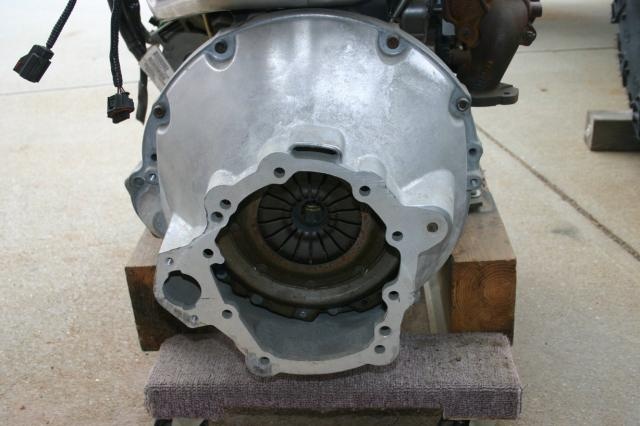

I use car-part.com all the time. :D I have searched a multitude of times for all of these parts, the main issue is just that all of the yards are so far away from me. 2.5+ hours one way. I agree about asking them for some photos, I think I'll give that a shot. I use ebay as well for pictures of specific parts, but it's tough when the parts aren't listed. :sad1:
Can anyone confirm the 3.7L bellhousing is a passenger side starter? I feel like I've read this before but now I'm doubting it for some reason. If it is indeed passenger side starter than I don't see any point in pursuing using the 3.7L bell. I'm still looking for details on the 4.7L flywheel as it should work in the 3.9L bell.
I found several pictures that led me to believe it is a drivers side mount, but didn't post anything because I wasn't sure I wasn't being tricked.
I can try and find them again tomorrow and post one or two, if you want. Just didn't want to lead anyone down the wrong path.

attachment.php
This pic you've previously posted IS a Jeep Liberty 3.7L V6 bellhousing. I can tell because it is less "phat" than the Dakota 3.9L V6 bellhousing. And yes, the starter is on the DRIVERS side.

I found several picture that led me to believe it is a drivers side mount, but didn't post anything because I wasn't sure I wasn't being tricked.
Can't lead anyone astray when nobody is sure! I won't turn down any help.
attachment.php
http://www.factorychryslerparts.com...iveline=7463&ukey_trimlevel=18760&modelYear=0
Greg
Greg, hate to disappoint but you're looking at the diagram for an NSG370 6-speed 3.7L from 2009. Totally diffetent from the 01-04 bellhousings listed in your original guide. As for the bellhousing above, until we can find a visual representation of the 3.7L, I'm inclined to continue assuming that's a 3.9L bell.
Going WAY back through my emails and pic, I've found two pics Clair sent me many years ago of HIS 3.7L V6 bellhousing. It is IDENTICAL to the pic you posted. Since I'm unable to post it here (don't know why), I can send it to you to post.
BTW, on the right is a genuine Dodge Dakota 3.9l V6 bellhousing. I should know, it used to belong to me (but now belongs to 71Scamper!).
attachment.php
Notice it has TWO slots on top while the bell in your pic has one. They are not the same. The bell in your pic is the Liberty V6 bell also used for the Jeep 2.8L Diesel. Also notice the starter pocket is tucked in a tad closer to the block than the Dakota.

I think Greg is right. I found the same picture online and read what the guy was saying when he posted it, and per my understanding that would be a 3.7L bellhousing.
Here is the thread I found it in.
Also, I noticed that the above pictured one doesn't have a slot for the crank sensor, while the 3.9 Dakota one's do, in addition to differences in where the vent is.
The thing that confuses me is, Clair made it sound like there are no provisions for mounting a starter, while I see bosses there. I suspect they aren't tapped and are oversized, but there is still a flange and holes. He also said it wasn't deep enough, but that could be fix with a dremel or something. Is it not possible that there is enough meat there to use the holes and bolt up a standard starter? Maybe a helicoil or something would bring it down to the right sizes, or build a plate that has studs or something that fits on from the back side? Oh wait, I'm assuming the bolt pattern would be the same, aren't I.
I'd sure like to see those picture Clair sent you, Greg. I'd be willing to put them on my photobucket account and link them here, if there were no issues.
Compared pictures of a Liberty starter to a Dakota one on RockAuto, and I don't think things will line up. Darn.

Here's the pictures Greg has:
Guilty as charged! I'm glad to be wrong either way, more options are a good thing... From what I remember, Clair's post said that the bellhousing had no provision for mounting the starter because it used a metal plate. I've seen similar plates that go between the engine and the bellhousing before on scattershields. I'm not sure if it's a similar situation or what it is, I've obviously never seen one. It would be awesome if we could get him to chip in on the discussion. However, currently the 4.7L may offer the option of using a factory flywheel (11"/143-tooth) that matches the 5.7 crank bolt pattern with the 3.9L bellhousing. That is if it isn't a dual mass flywheel... I'm not sure of any factory options in the 10.5" range.
