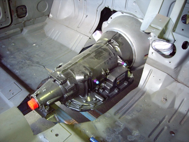

Unfortunately Chrysler Australia being the tight asses they were, decided to use the USA floor and firewall design in the RH drive Aussie units. This put the engine in the same place as you would find them in the US built cars. They then hung a steering box from the RH chassis rail because of clearance issues and not from the K frame like it should have been. Needless to say the chassis rail is prone to cracking where the box is mounted. I guess the right way to do this would be to offset the engine to the left hand side for better steering clearance, move the tunnel and the diff centerline to suit.
Sometimes you have to cut big holes in your floor when your building Mopars.

Just to correct you here, the engine is not in the center of the engine bay. It is angled across the engine bay. To properly centre it you will need to cut the trans tunnel and also move the transmission over. Then change your diff center location if you want to keep everything in alignment.
Good point Bakerlite , having the engine centered does not necessarily put the whole engine in the center of the engine bay . However there is some room in the tunnel to get it close , or center with some creative clearancing , the RHD Big Block guys do it often .
Also the K set up I showed does have some adjustability , one should be able to find a happy compromise .
Alot depends on the trans you want to use .

Yes Bakerlite I agree , Chrysler Australia ( who I guess was heavily controlled by Chrysler USA ) could have done the conversion so much better .
Nice beginings there, is that a NAG 1 you are using .
For the benefit of the US guys, the Aussie licensing rules are pretty strict so these sort of conversions generally need to be signed off by an engineer before they are allowed on the road. It really comes done to how far you want to go with the conversion and if you start to cot out the transmission crossmember or use after market front ends you just add to the complexity an cost of the licensing process so this is not for everybody.

Mo-cars, that's a 6 speed GM box and a customers car.
