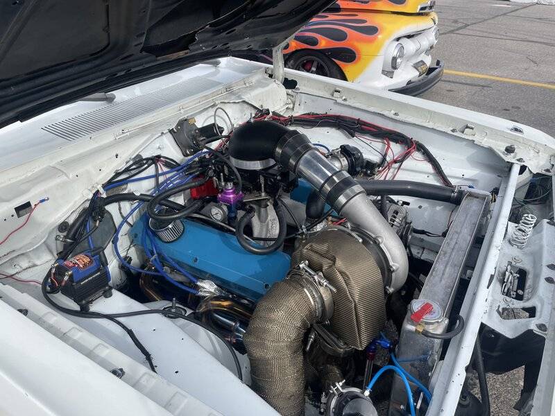

I didn't do that great.. bunch of problems. Off the trailer it ran [email protected] With a 1.91 60ft lol I also lost brakes, glad it was only 1/8th mile.
2nd run was botched, I must've not tightened a bowl bolt fkr the carb. Leaned out hard and just putted down the track trying to keep it running.
Last run, 6.82@103 (1.66 60ft) breaking up and let off. Made 8.5psi, pulled haaarrrdddd. Gotta figure out the breaking up part.
Afr was 12.0 at wot (I wanted 11.4-11.8) it's possible it's spark plug or even timing related. More stuff to work on.

Since Vegas I've been tuning the carburetor, found my boost reference power valve was partially hung up and the plunger didn't freely move. So I purchased an adjustable simple stage brpv.
I can say that now when I stomp it in 3rd at 60+mph it annihilates the tires, even at 7.1psi.
10.9 to 11.0afr (that I could see while trying to keep the car straight) 34° total timing, .5° pulled per psi after 2psi
Smooth acceleration, no more breakup or high rpm stumble.
This car is a blast to drive.
It almost feels like it's blowing through the converter, but I'm sure that will show itself on a prepped track.
It was definitely blowing through the converter or slipping. Ran a couple of 10.7 passes a couple weeks ago.
10.79@114 letting off at the 1000ft 9.3psi boost (dragy numbers are a little off from timeslip)
10.74@126 7200rpm at the strip (3.55 gears) 10.4psi slipping hard shift light on the entire pass and couldn't hear the shift change.
I ended up pulling a bunch of timing and getting to run on gate. Added a bit of fluid to the trans and bam, the converter seemed to couple. Short track was horrible. But mph is muey bueno for 7.4psi and 6000ft da. I guess next step is to see if adding the timing back has any effect on the converter (maybe it was just enough torque to make it not happy Or maybe it was just low on fluid?)
And I wired up the 2 step in the msd box. Set to 3000rpm. Tested it out on foot brake and hot damn it builds boost. Wish I did that at the track.

That run, 30° total, pulling .5° per psi after 2psi. Normally 34° with the same retard for boost.
Maybe 1/2 a quart. Maybe a little more. I was adding to check the stick from a gallon jug. It didn't slip like most trans slip when low. Maybe the converter didn't fill up? I don't know, but I'll find out next track day if it couple's and works.
The engine may like the lower timing better. The higher mph with lower timing might not be JUST the converter coupling. Any chance you have a comparison of the spark plugs before and after the timing change?
I didn't have fresh ones. But they look almost identical aside from the timing mark change. I've tested both timing changes on fresh sets before. Which is why I chose the 4° change. It will probably stay there as it seems to be happier over all with less timing. 32 was it's happy spot NA.
Not sure why I set it to 34 I don't remember what I was testing. Lol
And I could feel the gear change. As if it was working properly. But that may not have anything to do with the timing and could be the fact I added a Bit of fluid. I'm still stoked it did 131 with 7 psi. Lol
