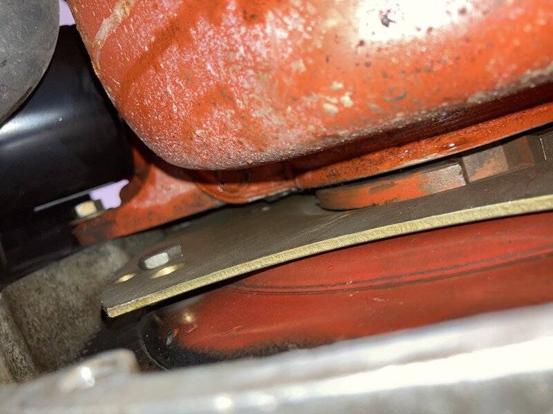

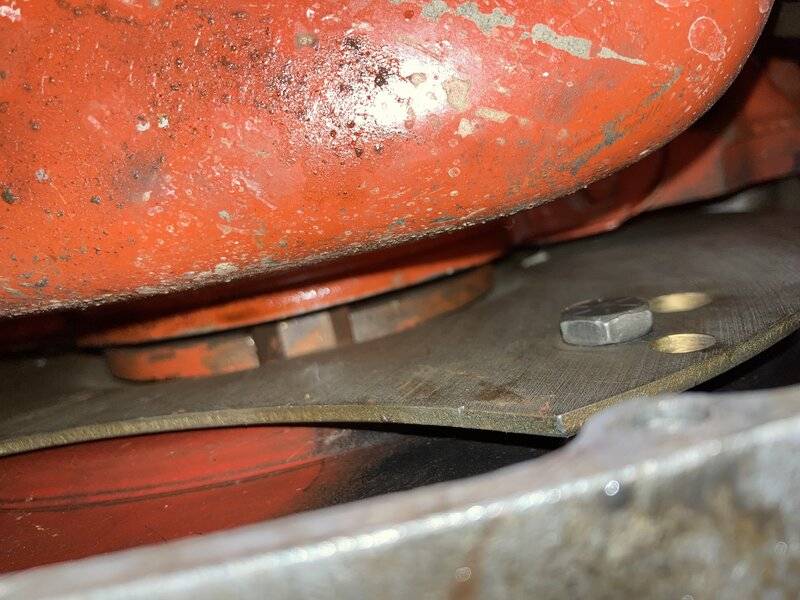

didn't see a crack in the flex plate but I just took the small inspection cover off.
Might have to pull the starter and get a better look.
everything looks good back here.

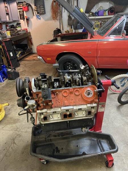

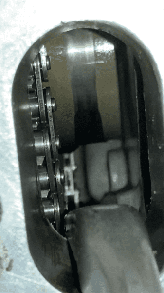

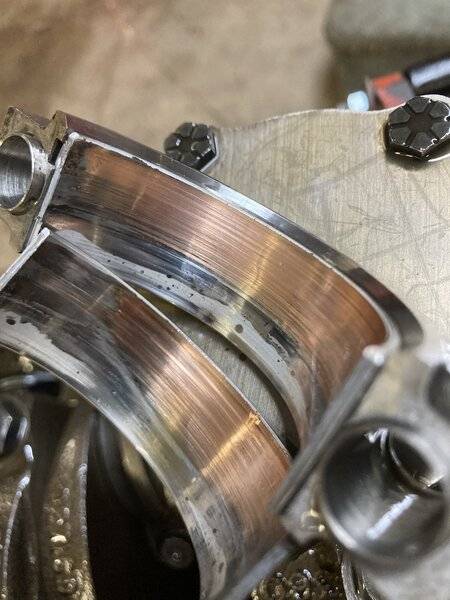

Odd that it is on only one side. Bent connecting rod???
OK, I take it back. It is definitely NOT an exhaust leak!
Skep419 It appears that you had that feeling way back on post #11.
That just sucks, it does look like a bent rod. Ever been hydro locked ?
