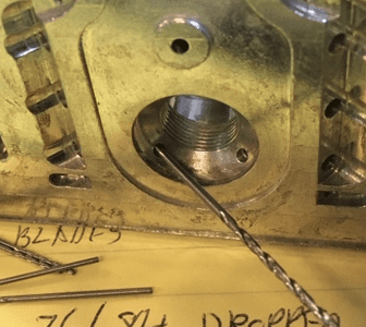

this is where i found the .054"

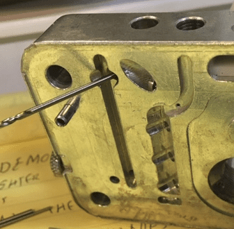

Primary and Secondary metering block are both the same
EDIT: IFR is a tapered jet and the small end is .033"
They say a picture is worth a 1000 words.
Ugh.
Tell us that's just a qualifying hole and the restriction is at the bottom.
It looks like it slotted and unscrews. yes?
Got two choices in that case. Buy the smaller ones or make out of set screws.
And we see the e-holes aren't threaded either.
If you have soft lead, you can gently plug the bottom or middle ones.
Or you can tap them and do the set screw thing.
Those blocks look like the've lowered the air well. I've seen that but havent dealt with them myself.

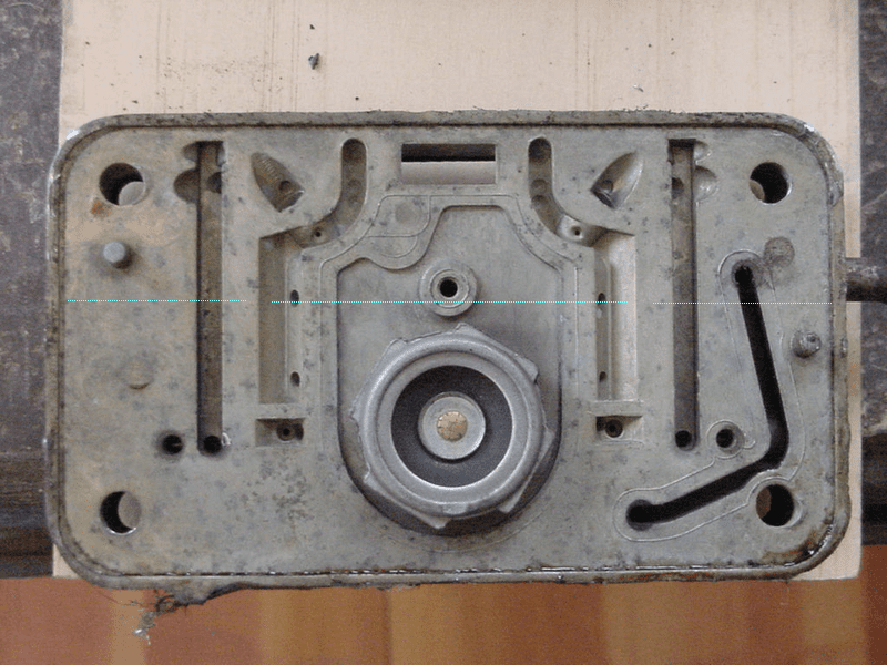

Compare that with the ones this guy bought
Need Quick Fuel carb tuning assistance
or this 3310-2
Fuel level is roughly at the same hight as the upper emulsion bleed (e-hole).
Lowere-hole is above PVCRs.
That's why plugging the bottom e-hole on those deep well blocks may be a starting point.
Nope its in the top and yes it is screwed in the top but would have to be drilled and tapped to put it in the bottom.
Yup no threads in the e holes.
I'm just saying if the IFR is .054 all the way through, and it seems like it is, then unscrew it and put an .033 something like that in there.
edit:
And lead is just a quick and dirty way to get two e-holes in the .027 range without tapping and drilling.
so all 4 corners aka 4 .033" IFR's
For four corner idle, and the transfer slots are about the same lengths, I would think square is a good starting point.
The good 3310 blocks you have are .033 or .035 right?
And I thought this starting point was for a carb with similar throttles and venturis.
.031, .033, .035 are all pretty typical IFR.
.053 is way out of line IMO
Went out and remove the IFR jet.....It is tapered. small end is .033"
That is a MASSIVE IFR.
I agree that .033 is a good starting point and a .070-.072 IAB.
Damn. That .054 IFR puts a ton of fuel in at idle.
RE read and note my EDITS. there only .033", IFR jet is tapered and the bottom is .033"
The Demon catalog shows the IFR for a downleg booster 850 Mighty Demon is supposed to be .038”.
Emulsion holes- bottom .033”, other two 031”.
Siphon break .028”
PVCR .059”
IAB .070
HSAB .031
Stock jetting 85/93

Looking at your “build sheet”, it would appear much of what you’ve listed for orifice sizing on the Demon blocks doesn’t agree with the specs in the catalog.
After thinking about your rich idle situation....... and the fact that you can get a .054” drill bit pretty far into the IFR....... if just doesn’t seem to want to come around....... I’d replace those with “fresh” IFR’s that were the desired size all the way through.
The length of the restriction is a factor(at least it is with jets).

I'm not going to condemn the metering block or that it has been modified.......I need to re check it all the next time it's apart. Pulled out all my pin vic drill bits and for an example i said that the emulsion hole were 29 and 25s.......I have a 22 31 and a 33 so don't know where that came from except poor judgment on my part.
Will be more diligent with the next measuring.
