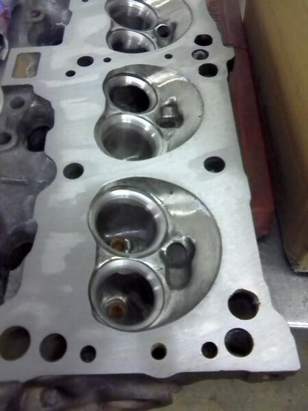

I had a 318 in my Duster, KB pistons 9.4-1 comp with stock Edelbrock heads, cam .545 lift cam, air gap intake, 430 gears, great street car! drove it to the track, full interior went 11.70s on good day and 11.80s in bad weather. 318s run great just need to have the combo right.
318 + 030
KB167s
Zero Decked
Balanced
Aeroflow Heads
9.4:1 comp
Comp XE268 cam
LD340 and Holley 600 Vac Sec
Shorty Headers, 2.5" dual exhaust
4 speed
2.92 Hwy diff (for now)
First start up very close!
