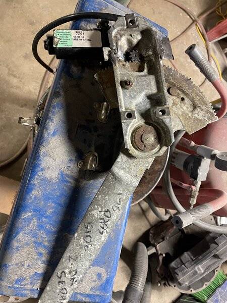

Bringing this thread back to life! I read the whole thing and was wondering if you had any pictures of the installed regulator?

@plumkrazee70 here’s my passenger regulator with the motor

Thanks! I just got my junkyard regulators and motors yesterday. To clarify, do I need to remove the spring on the factory regulator?
flip it over and the "up" spring on that side should be removed or it goes up WaYYYYYYYYY to fast. but be careful it's a finger accident waiting to happen, just crank it up all the way up once you get it out of the car to relieve some tension to be a bit safer and clamp it down when you remove it.
