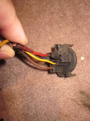

Has anyone found a source for the early (pre 69) dash mounted ignition switches? I can find them for Chevys and Fords but not Chryslers.
I have a donor harness 68 i think.
I'll check if the ignition connector is usable
I checked my donor harness and the ignition connector is MIA.
sorry.
BTW this photo is from my non donor 67 dart harness. It would be what you are looking for.

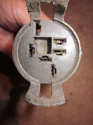

Yep 67 is unique, that's why I asked for the year. I have a 67 style as well, same as Dartsun posted.
68's are different and clip onto switch.
The plastic housing itself but one with the wires and pigtail if necessary.
How do the early ones differ? I figured they were all the same.
