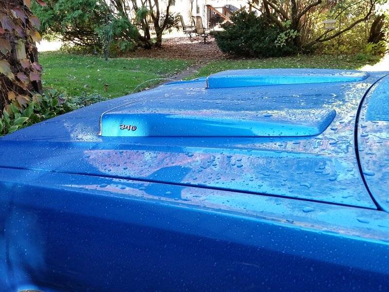

I had the twin scoops on my hood for a few years before I built up the nerve to make them "functional". I purchased a set of the hood scoop grommets from DetroitMuscleTechnologies.com. I used tape on the top side of the hood, taped some plastic to the underside of the hood (to collect the metal shavings), drilled a pilot hole and then used a 4 1/8" hole saw.
I would suggest using some scrap material and different sized hole saws to get the perfect match for the grommets you plan to use!
And now they're "functional"!

Then a few years later (2018) I had my buddy, Trent, apply the gloss black paint (V21 style) to the hood, scoops and cowl.
And the car gets driven in the rain
