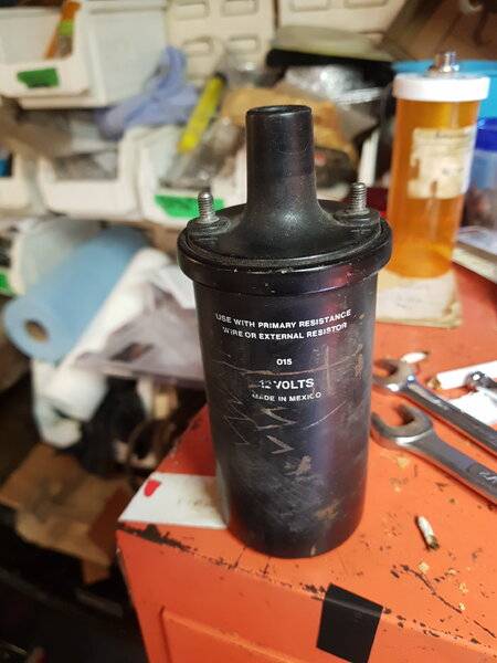

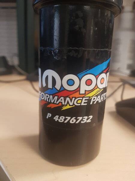

So back at it, finished eddy carb kit. While carb is off I checked coil. Primary 1.4k and 2ndary 8.49k.
No number on coil, just "015".
MP coil 0.8K primary, 2ndary 4.39k. The MP appear to be in spec, but the no name is roughly twice the resistance??

I dont have a new coil, the spare is the MP one and its rated at 1/2 the resistance on both primary and secondary, so I was worried too much voltage(ohms law) killing something. I havent been able to find concrete factory coil specs and ballast resistor specs. The br installed is 0.6 ohm with everything unhooked.

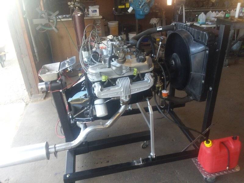

I am fortunate to have a proven good running engine on my test run stand that I use for testing carbs.
Friend brought by a 1400 Rebuilt Edelbrock for me to test run. Immediately ran bad, a lot like the way your engine is running. Dead and popping on acceleration. changed metering rods, springs, adjusted idle jets, No Joy.
Pulled off that 1400 carb and put on my known good 1406 Edelbrock, and it immediately fired right up and ran perfect. You could just tell by the tone of it that it was right.
I am not hearing that good tone with your engine running in the video with the 1405 on it.

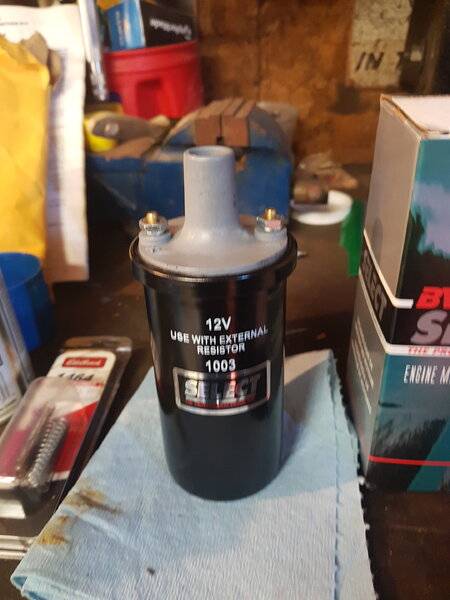

Didnt get time spent, but got $$ spent. Canadian Tire had a BWD Coil in stock. Primary 1.4 ohms, 2ndary 8.93K ohms. Same specs as coil in car.
This one was $70!
Found another SMP UC12 for 1/2 the price, and recommended ballast is RU37, but specs for that ballast is 1.2 ohms? One currently in car is 0.6.
