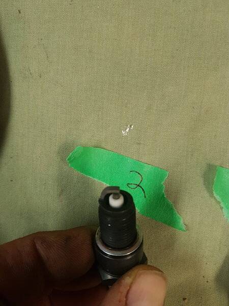

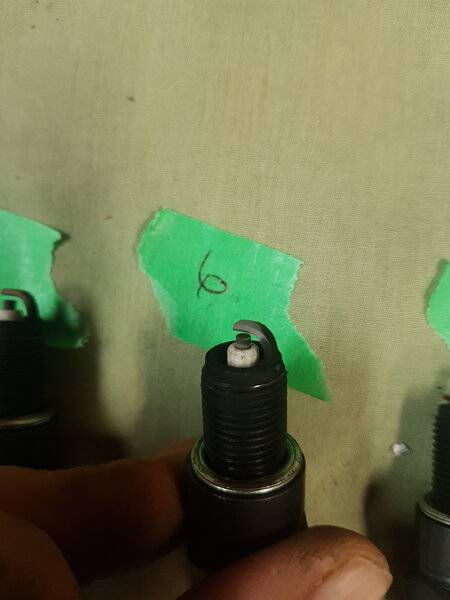

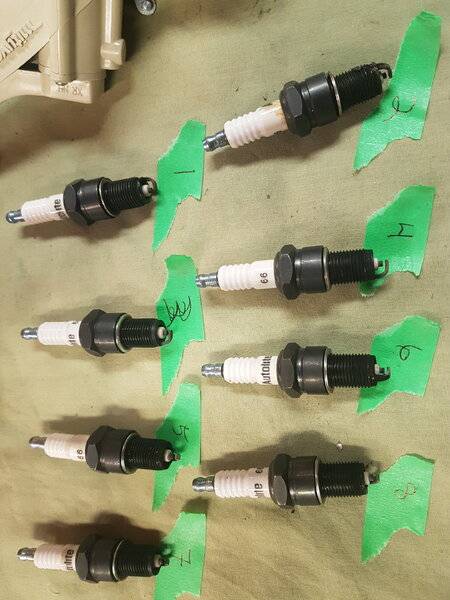

Woke up early today and spent an hour on cuda. Pulled Autolite plugs that have maybe 600-700 miles. I pulled them 2 weeks back and cleaned them and reinstalled. Pulled them and installed Champ RN14YC.

Not getting enough fuel, those insulators on the plugs are too white.
Lean situation = poping
Want them looking more like this for a good running engine.
The thing with used carbs is they sit around and get plugged internally, really hard to get them cleaned out properly. No easy task.
Resulting in poor fuel flow of the internal passages.
