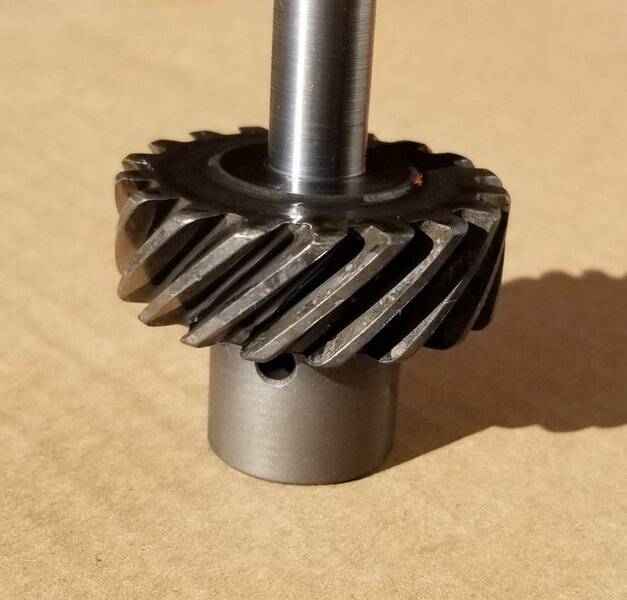

Here’s from another forum “After 7,000 plus miles and hundreds of dragstrip passes, here is what the Crane melonized gear looks like after use with a Howards hydraulic roller cam.”
I would like to know if that gear was run in a HV/HP pump! I really would like to have a better pump than a stock one, but the warning on the Hughes website is concerning, still.

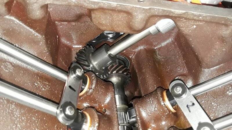

Well, the verdict is in. Pulled a valve cover and wiped the rail with my finger onto a blue towel. If you look closely you'll see the small brass "sacrifice". Time to pull the engine.
Yeah, that’s not good.
It’s hard to see in the picture but that almost looks like a sintered bronze or oilite bushing material.
Not saying it is because it may be the picture but usually brass doesn’t make chips like that.
At least not the brass they use for those gears.

Did you cut the filter open?
I did not. Since the gear was eaten and I found metal in the oil on the valve cover rail I did not see the point. I'm sure the filter picked up a lot of metal, that's it's job. To me the point of inspecting the filter would be at an oil change to ensure the engine was healthy. I now know it is not. I do really appreciate all the feedback folks have given me on this issue. I'm just concerned now about what I will find in my roller rockers & lifters when I tear things down. They were really expensive...
