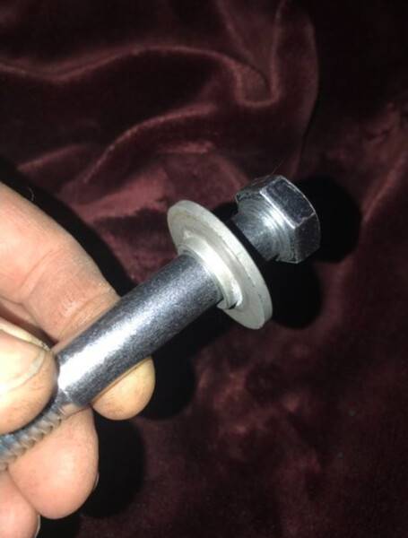

If you go with QA1, one thing I will recommend is to use the spacer washer from a modern Dodge Ram steering rack to center the K-member into the car. The flat washers that QA1 sends with their kit doesnt necessarily center the K-member to sit square when you're bolting it in. The spacer is a perfect fit inside of the upright tube and it keeps everything aligned. I've also heard that it'll tighten up the suspension when going around turns. No personal experience with that yet though
Edit: Part # is 68401387AA. You'll need 2 of them. They are not cheap.
Spacer looks like this:
Good luck with whatever direction you choose.
