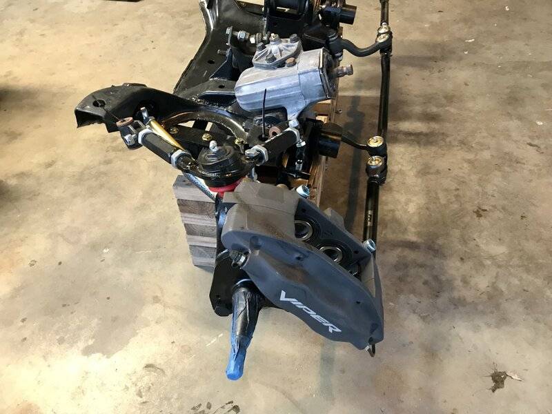

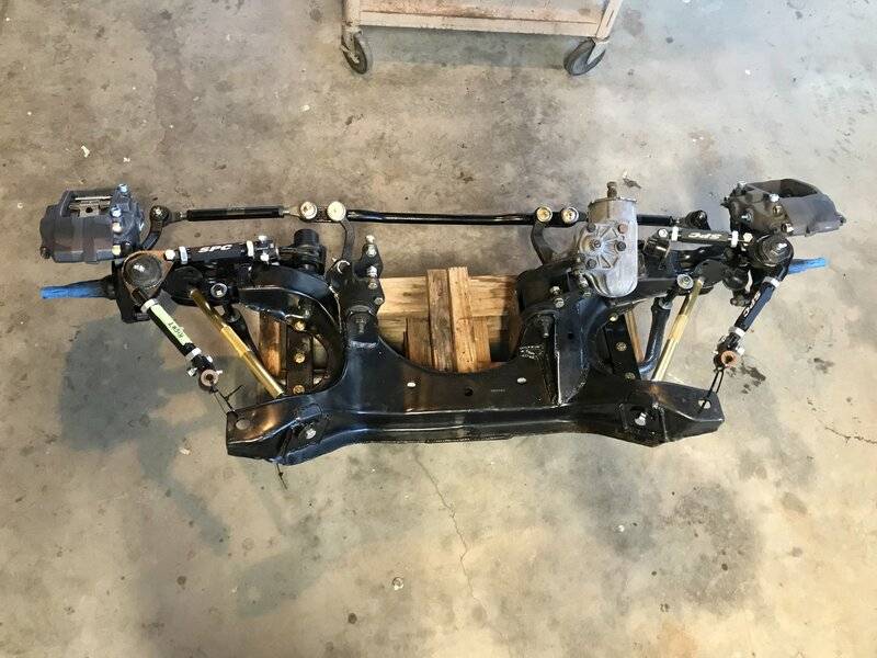

we can package a redone factory k with all the components installed already. This way, our solution is sexier.
This is pretty sexy. Would it be to this completion? How far and how customizable?
