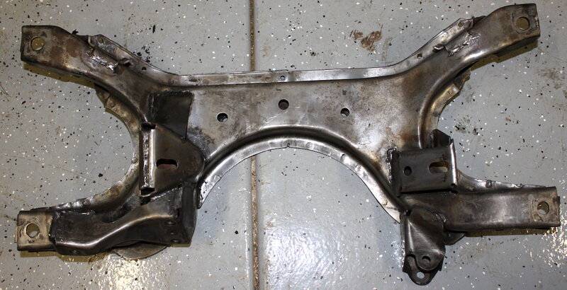

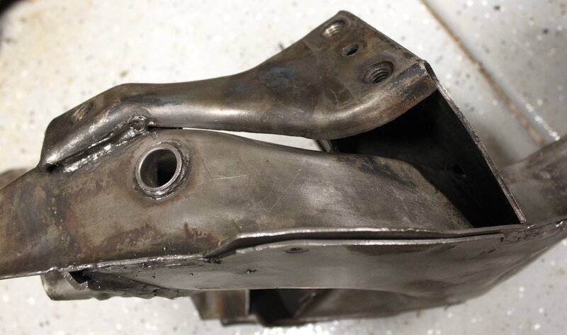

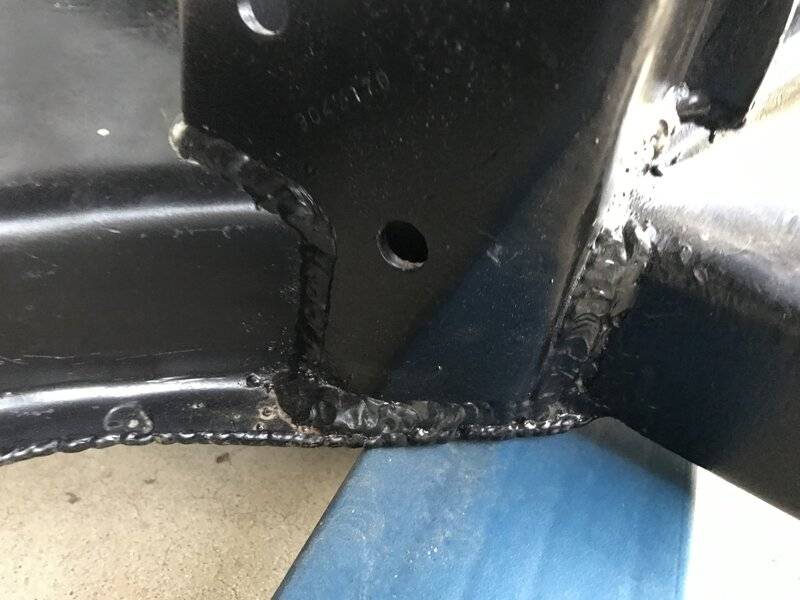

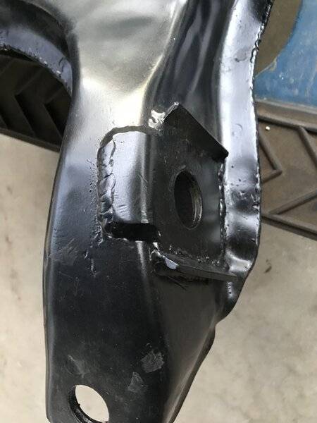

If I may suggest a few things I would address with this build, check the LCA mounts in the K member. They are notorious for separating from the k-frame. … Gussetting helps bigtime. Please post some pics of your project. We all would like to see em!!
Here’s the gusseted k-frame. I started with torching the seams and sand blasting. I popped the two halves open and burned more grease out. Finally got tanked. I used the Firm Feel gusset kit.
The torsion bar sockets are also going to be welded on the inside of the torsion bar crossmember. I will cut the floor open to access it.

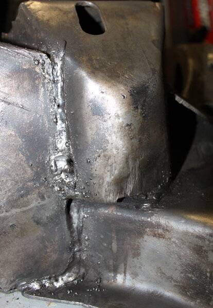

There's really no need to open up the torsion bar crossmember if it's solid. If the welds on the outside have good penetration then welding the inside doesn't do anything for you. Same really for the K, although if you have issues with the LCA pivot tubes you do have to open the K to get to the forward end of the those if the welds have broken loose.

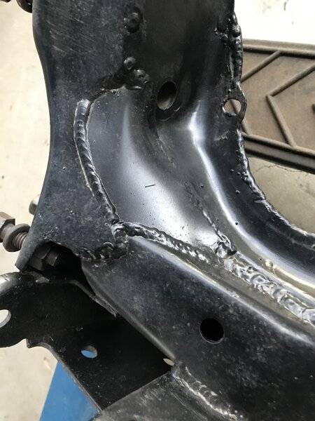

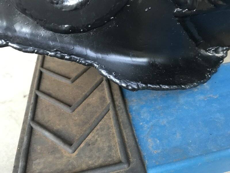

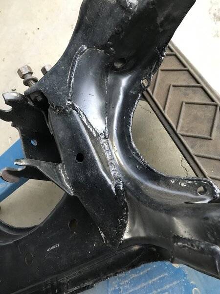

I just degreased and pressure washed the K's for my cars. From a welding standpoint I had more issues with porosity in the factory welds bleeding over into my welds when I went over the originals than I did with grease contamination. But I wasn't going to grind out all the factory welds and start completely over.
This is the K from my EL5 '71 GT, after I cleaned it up (again, no hot tanking, no sandblasting, just some degreaser and a scrub brush, followed by some pressure washing.) The factory welds are pretty bad
After I seam welded, gusseted, and went over the factory welds. Between my Dart and my Duster one of them got a Firm Feel gusset kit, the other one I just made all the gussets myself. They're pretty self explanatory anyway.

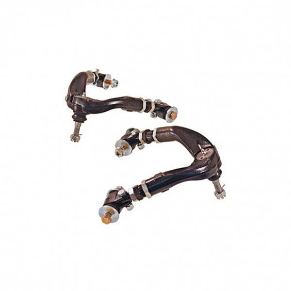

I'm looking at these upper control arms with locking/jam nuts on the inner mounts. How reliable are these? Looks to me that it could be very sketchy if one of those jam nuts were to back off. Do you really get a lot of use out of the adjustments in the real world? Is this something you would fool with after the car is dialled in? I would think the eccentrics would be enough .

These would be best suited for someone that is tracking their car often. Alignment is much quicker since you don't have to deal with the eccentric bolts. I'm sure they also offer much more caster and camber too.

I've never had an issue with one of those jam nuts coming loose. Torque to spec. A couple drops of loctite would be fine for peace of mind, but I don't use any. You'd actually need to have BOTH jam nuts come loose for the setting to change, and then the adjuster would have to turn too.
And yes, the adjustments do help a lot in the real world. The camber bolts are only good for like +/- 1.3° if I remember right. Which is why without offset bushings most folk struggle with getting more than a couple degrees of + caster. With the SPC control arms you have a much larger adjustable range. Like I run +6.5° of caster and -1° of camber and I have a ton of adjustment left still. And changing the alignment is a lot easier.
Do I fool with it now that I have it dialed in? No, not really. But I'm not doing events or track days. It's something you could change from one track to another if you knew the track and your car. But, in the process of dialing it in I've run everywhere from -.5° of camber and +3.5° of caster all the way up to -1.5° of camber and +8° of caster. So I settled on my current specs after running through a large range of adjustment. Now granted not all of that was with the SPC's, I started with 73+ UCA's and offset bushings and used a non adjustable set of tubular UCA's before going to the SPC's. But with the SPC's I could have done all of it without ever changing out suspension components.
