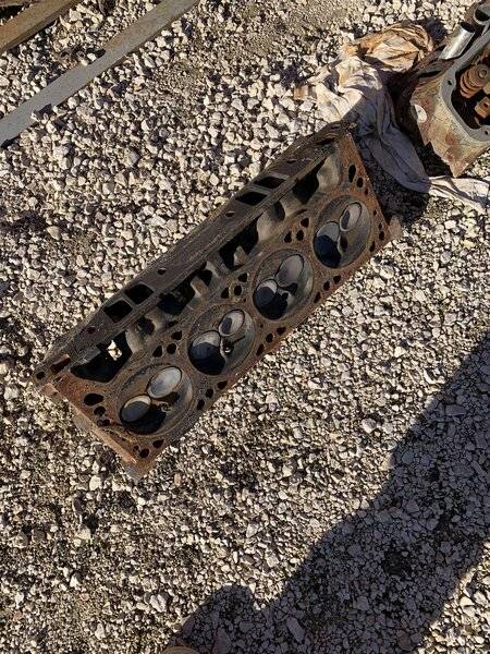

Speaking of magnum heads I tried to sell a good set for $30… nobody even asked about them…so I tossed them outside
