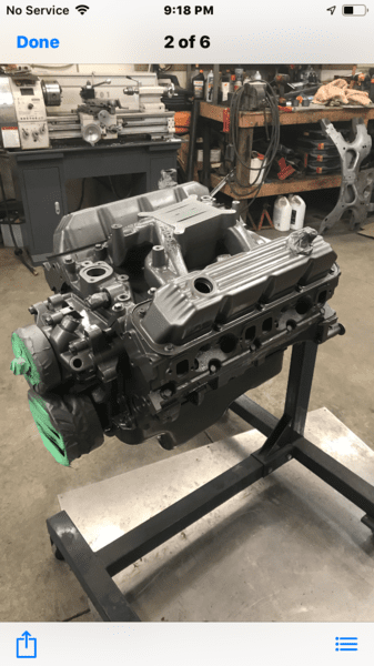

Mild 360 Magnum Build
The install report is perhaps a bit different from what is the norm EQ head build due to the longer valves we installed. We ended up shimming the pedestals up .165 in order to get the rocker arms to stay centered on the valve tip throughout the rotation. The pushrod ended up at 7.025 I believe, this had the valve train staying nice a straight with no funny angles on the push rods or rockers.

I forgot about this thing... should get dragged to the Dyno soon before I get to deep into my “ free cam build “

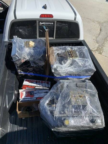

1750 Horsepower off to the Dyno….including the long forgotten 360 magnum
Can’t wait to see the results! What cam did you end up using for this build?
From front to back:
400 inch small block Chevy with CNC pro-max heads pump gas
500 inch big block Mopar with Indy heads 14 to 1
360 Magnum Stock bottom end EQ heads
