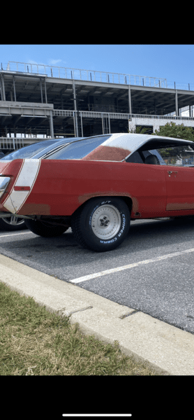

Looks like plenty of room on the outside. Where do they rub? 255's here on 15x7 with a 4.25 backspace. Just an extra leaf on mine.

Well I talking about my duster now but . My 72 dart with leaf spring in boarding kit my 255s barely clear but on hard turns my 255/70/15 rub Frame & trunk well a little . Not my quarter .
Keep in mind these cars are not that exact same . I've seen stuff 1/8 and 1/4 off on exact year and make original cars .even graveyard cars talked about that . 1/4 is alot for tire Clearance lol

72 dart , 8 3/4 rear , old style leaf spring inboard kit which moves leafs in like 3/4 " . My 255/70/15 cooper Cobras barely fit . Rub frame rail and inner trunk well on hard turns where body rolls . Not taller talkinf about clearances here . I'm talking about these air shocks not holding pressure and leaking down over 2-3 week period.

On both my cars my 71 duster with 275/60/15 . No leaf spring inboard kit , rub quarter if car is too low .
72 dart with leader spring inboard kit , rubs frame with 255/70/15 on hard turns

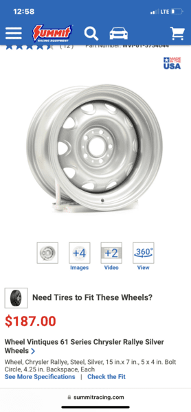

Wheel Vintiques 61-5754044 Wheel Vintiques 61 Series Chrysler Rallye Silver Wheels | Summit Racing

These wheels suck lol . They're all horribly imbalanced but it's only wheel we can afford and in 15" and in small bolt pattern. We like the police style 14" wheel ideally but they don't make in small bolt pattern.
Not for this guy, but for others reading this post. 5 on 4" bolt circle,
The car was designed for and came with a 14 x 5.5" rim. 8" section width. a 25" tall tire. D or E-70 x 14 or smaller.
We are trying to fit a 15x7" rim with a 28-29" tall tire. 10.8' section width. 4.25" Back space. 275/60-15
Fitment charts say this won't fit, true.
Tire is too wide for the rim, should be 8".
Fitment charts recommend for this car a 14x7 or 15x6 max for fit. With the 4" bolt pattern ( limited rim selection)
Like trying to put 5lbs of s**t in a 1lb bag.
Biggest problem, wrong tire and rim offset (bolt pattern doesn't help either.)
Solutions.
(1) If you have to have that size tire/wheel you have to $pend. Offset spring kit, possible inner wheel tub mod. bolt pattern upgrade.
(2) Easiest, smaller tire. The 7" rim is designed for a 235-245mm tire size 9.25 section width, 26" tall
Solutions.
