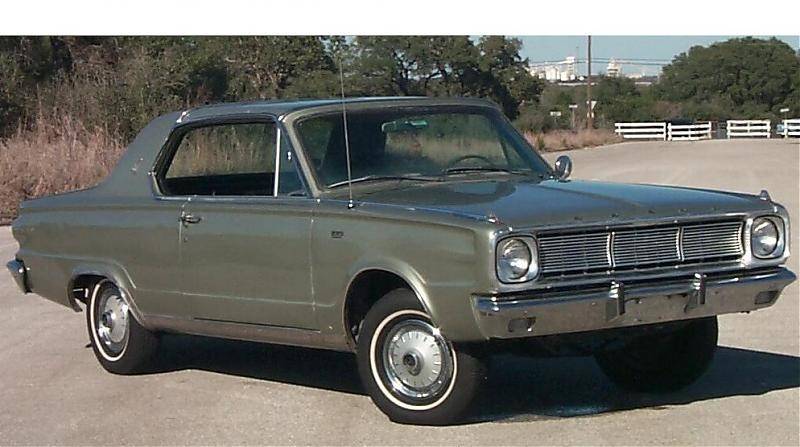

I'd consider myself a purist and at first, I didn't understand what was up. You've done some well thought out, quality work. Having done a full restoration of a '66 GT coupe, it is interesting to see what you have done. I'm curious to see how you will handle the exhaust under the passenger side of the car.
Best of luck with your race car. It's great to see some '66s that'll kick some brand-x butt.8)
