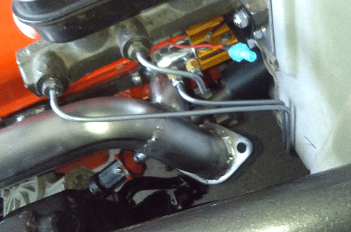

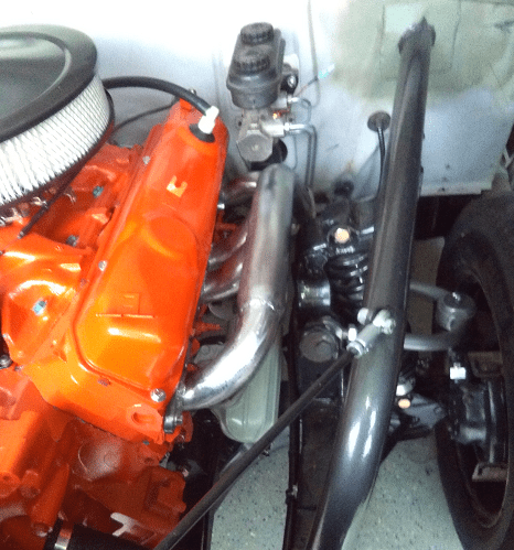

We've been busy looking for a new house, so I haven't been getting much done lately, but I did get the passenger's side finished. I just have to squirt some high heat paint on it. I'm happy with the fit. Hopefully I can finish the driver's side soon and get this junk fired up.
Not much new, but I was able to finish the driver's side 'manifold' today. The exhaust flange is a a little close to the steering shaft, but it should work fine. If it bugs me enough, I can always extend it a couple inches. I'll spray on some black bbq paint to finish them off. Then it's time to run a couple pipes to the rear axle with the cheapie mufflers. It's getting closer...
Got the exhaust finished up with some cheapie flowmaster copies and made up a set of plug wires. Almost time to put 12 volts to the ignition and starter and fire this pig up.

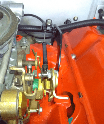

Another minor item checked off the list. Got a throttle bracket made (modified from a small block bracket) and made up a throttle stud from a #12 machine screw. When the hotrod motor goes in, I'll likely be modifying it again to fit the victor manifold and carb spacer. I'll probably be getting a cable of appropriate length then too. This will work for now though.

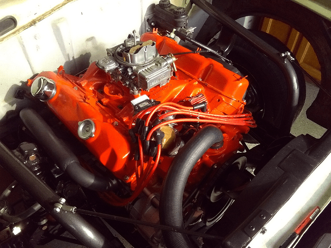

Well, I totally failed and didn't get a quality video, but my buddy and I got this pig fired up. It purrs like a kitten, as you'd expect from a stock 400.
Unfortunately, I wasn't able to get it running for long since the alternator wasn't hooked up and we basically just used a battery and some jumper cables. You could tell the starter was not happy with that setup - nor was the ignition. We accomplished what we wanted though.

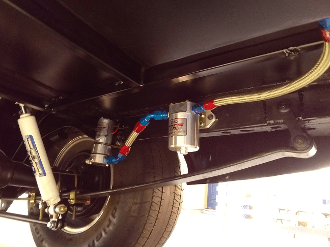

I pulled the car out this past weekend to redo a couple tubes in the roll cage and got a couple shots of the fuel system and rear axle. I still need to route the feed and return lines, but that's no big deal. The supply line from the fuel cell to the filter/pump is -10an. From there, I'll be running -8 feed and return lines.
After I redo the rear cage bars, I'll be cleaning up the trunk, squirting on some paint and start running some wires. I just need to decide on a color.

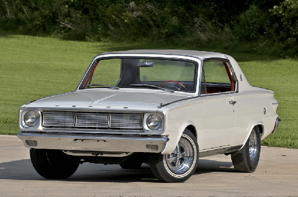

Alright guys, I need help deciding on a color for my 66. It'll eventually have a hood scoop - not sure which one though. I kinda like the look of the Hemi scoop. Right now, I'm liking either an off-white like the original WW1, or maybe satin black (I know, I know - way played out).
Thoughts???
Go with the off-white. Ya don't want people thinking you're running primer until you decide on a color, do ya?
Haha! That's what I kinda like about it though. I've always been the type to go against the grain. That white does look killer on these early A's though.
I've seen some in a light purple and the looked fine but I'm partial to the orig. ruby red.

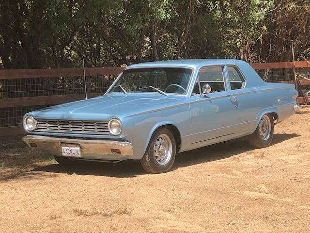

I never would have picked this color out of thin air but I had a '65 Dart in DD1 and repainted it in the original color:
View attachment 1715851127 View attachment 1715851128
That does look slick! Did you paint it yourself? Do you have a local place you get your paint, or do you order it online.
