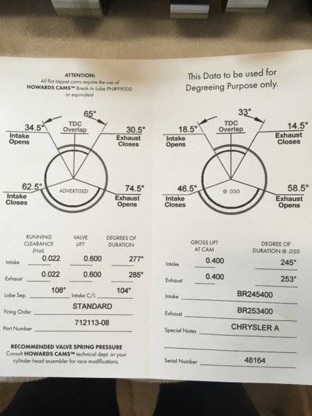

Santa Cams dropped off a little treasure this morning! Now for my first attempt at degreeing a camshaft. Yippee!
Checked for runout on the pump drive- none. Dead nuts. Dropped it in the block and it fits perfectly. Nice snug fit in the pump socket also.
Just my opinion, but I’d stick that in at 106. That is actually split overlap (centered overlap triangle) and as long as the headers are good, it will make more power there.
Again, just my opinion
mgispeedware.com and enter your numbers and you can see what I mean.
FYI, a piece of 3” exhaust tube is perfect for driving the crank snout seal into the timing cover. You’re welcome.
Could you elaborate some on this. I went to the website you mentioned and input my numbers but I’m not sure I understand how to interpret the info. My timing set is adjustable up to 8 degrees each way so putting it in 2 degrees retarded would be easy.
Put in all your info into the program and then add the 4 degrees advance where it asks for it and look at the “overlap triangle” where the exhaust closing side of the lobe crosses the opening side of the intake lobe at TDC.
IMO (and the opinion of others) when you are looking for the best power and you have good headers and such, you don’t want the intake lobe crossing the exhaust lobe before TDC.
When I did your numbers, at 4 degrees advance the triangle was ahead of the TDC line. At O degrees (what I call straight up) the cam is slightly retarded. But...at 2 degrees advance the triangle is centered.
I’ll see if I can post up the stuff here, but I doubt I can.

first I would get hold of Howard and nail down in writing if they want you to install your cam using the center of a presumably asymetrcal lobe i.e 104 Intake Centerline
OR
do they what you to use "for timing only" numbers off the cam card ie. Intake closes 46.5 at.050
which could differ by say 4 degrees (try both and see)
and ask them at what lift "advertised is" most likely .020 but could be different their lobe catalog might show
now
With what YR said
you would not be retarding your cam by 2 degrees
Your cam is most likely ground with 4 degrees built in
so you are advancing your cam 2 degrees instead of 4
What I would do
If your compression and dynamic compression is near the max go ahead and install it straight up or 2 degrees
if your compression and dynamic compression is on the low side then install it 4 degrees advanced (dot to dot cough cough)
