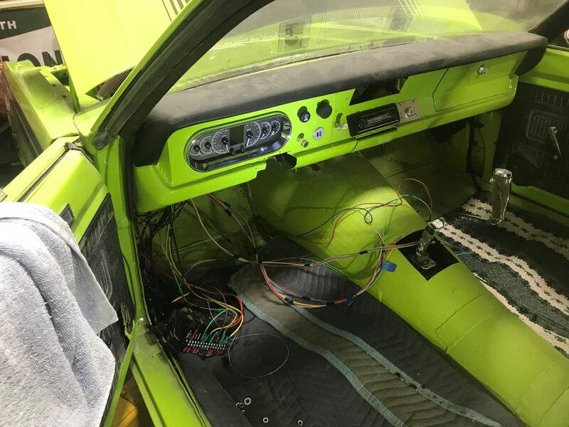

Just read through this, I like the method they use really not much metal removal just some "stretching" of the tunnel. Hard to tell from pics but @Sublime one 's trans tunnel looks pretty huge in comparison, almost comes up to the dash...
Just read through this, I like the method they use really not much metal removal just some "stretching" of the tunnel. Hard to tell from pics but @Sublime one 's trans tunnel looks pretty huge in comparison, almost comes up to the dash...[/QUOTE]
You are correct. The T6 is a beast. I likely could have made the tunnel a bit smaller but at that point I was working in free air space! I did not want to screw with it come time to start fabricating tranny mounts etc. l got me a bit of spare room if you will! I decided to error on side of larger vs to tight. I work alone and often times stuff like that can be a real pain by your self. I had to fabricate tranny mounts etc etc. turned out ok but no question the T60 is huge!
Here is a bit better pix of my T60 tunnel. Please note I did not use a kit, I just made it myself. Utilizing a kit would likely make a smaller tighter job? I just didn’t go that way.
