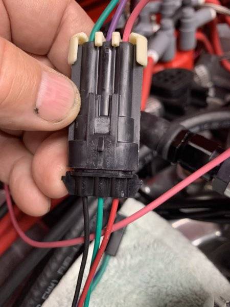

I am checking wire colors this morning. The MSD has a black and black with orange tracer coming out of it orange meaning positive that wire is hooked to the violet on the extension that goes to the box and the plugs match up there with the violet going to Violet and the green going to green. So they are color matched all the way from the MSD to the box. Now the hyper spark connectors look reversed to me but I ask on the sniper Facebook site and the guys looked it up and said no that’s right they switch at the distributor and both of them was the same I have had to hyper spark distributors so far both of them act the same As this MSD does.
