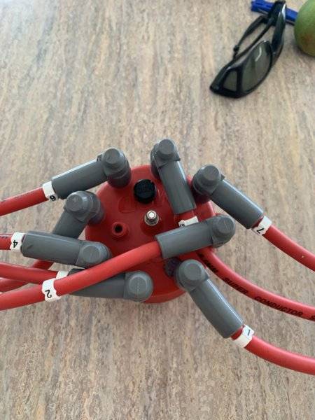

Maybe the dumbest question yet, but since this all started after you swapped out distributors.... Do you have the damn plug wires in the right order?

Yes I have checked the wires several times when changing between distributors and also checked the timing chain and gear set

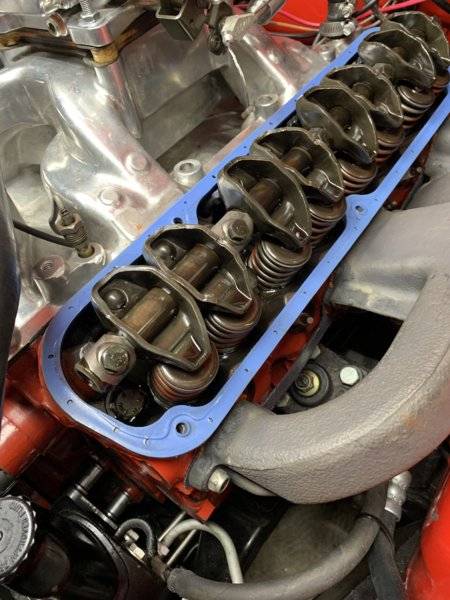

I am about ready to crank it up with the MSD. I have the damper set at 13° I turned the distributor so it is just passing the reluctor and the rotor is on number one this was a suggestion from one of you guys sounds like it was worth a try I will find out if this helps. In this picture you can see the brass rotor
aiming at number one
OK I tried it again with the MSD set up at 13°. Rotor pointing at number one with the reluctor just passing the pick up coil. I got the same result it will crank and crank and not fire once. until I turn the key off then it tries to run backwards and blows all kinds of gas out the top of that sniper. Then I grab the distributor crank it way over try again it starts right up runs on fast idle just like normal slows down to regular idle sounds perfect I checked the timing it’s at 45° I turn it down to 30 it’s still running I turn it off I restart it. it only turns over to or three times and it Starts right up. Now do you think this is OK it’s Idles until it got hot the fans kicked on everything seems normal. I drop it in gear it dies I’m sure I couldn’t even drive it down the street. I look in the window on the I can see the rotor firing right at number one at 40° This is kicking my ***

I think you are have the damper set to your timing mark but you are NOT on the compression stroke. So then when you line up your distributor, it is actually 180 degrees off. You can confirm you are coming up on the compression stroke by removing #1 plug and put your finger over the plug hole. When you crank it around by hand on the balancer, you will feel it pressurize and it will push your finger off the plug hole. That's where you need to be when you line up the dizzy to the #1 plug.

Rusty I know you keep saying that. I have done it every way possible I used a screwdriver in the hole and watched it I let it blow my finger off the number one. I checked it when I had the cam cover off and just put the damper back on to see where it lined up I’ve checked top dead center every way I could. I even had the head off And looked at number one and it was right up even with the deck.

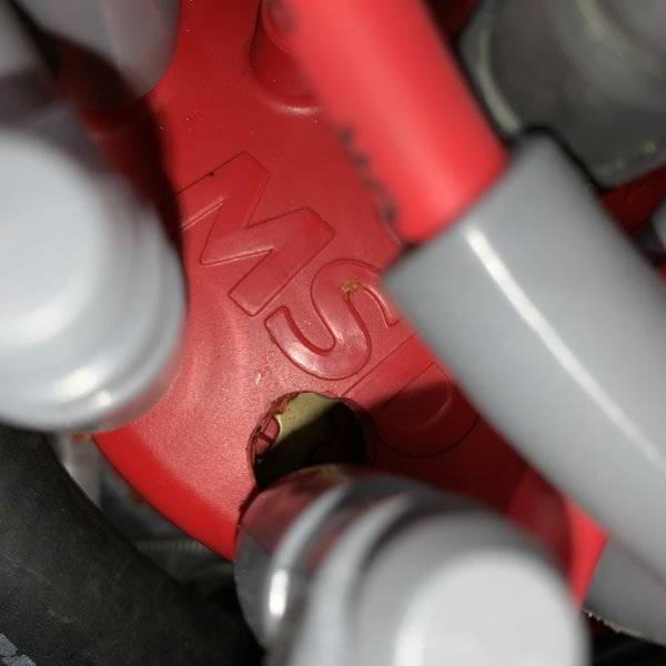

A couple of people have mentioned the MSD box it has always worked perfectly but there is a little box that came with the sniper set up that can eliminate the MSD box it’s called a coil driver I don’t know if it could be just throwing in an extra 20° of advance for some reason I’m going to try to find a diagram of how to wire it in

It’s hard to blame it on the box Because once I set the timing up it starts very good and runs pretty good. But that’s the only thing I haven’t tried to replace. So I am trying to find a wiring diagram to bypass the MSD box and use the coil driver that came with the kit. But all the wiring diagrams I find show it hooked up in A timing control situation Being triggered by the sniper I haven’t found one where it is being triggered by the distributor yet
