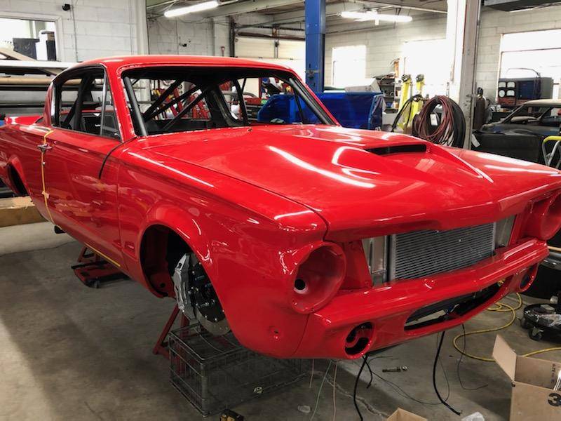

That looks amazing. Details and more pics please.

Thanks! It's way beyond my skill level; I just wrote the checks. Yours sounds like fun! What are your suspension plans?

Yeah, I looked at everything out there, and saw various disadvantages (or what I perceived as disadvantages) in all of them. I know a few people who have the Street Lynx setup and are pleased with it; that probably would have been my choice if I had not elected to go the IRS route. I had no intention of straying as far away from the norm as I did, but things kinda snowballed. The Detroit Speed Alumaframe system did help simplify things; we already had C7 Corvette components ready to go in, but decided to use the Alumaframe setup for an early Mustang, and built the frame rails with the appropriate spacing to accommodate that.

I am in Mississippi; unfortunately, the car is stuck in quarantine at the shop, Hot Rod Chassis and Cycle in Chicago. It was not completely finished when it went to SEMA in November, and still needs to go back to the upholstery shop and paint shop for some final details. Neither of those shops are allowed to work on my car; Governor Pritzker apparently thinks Barracudas are virus carriers. The guys at HRCC have gotten everything else done; the last thing was installing and wiring the wheel speed sensors for the traction control. When things open back up, the car will go to Blackdog Racing in Chicago for chassis tuning, and then to Dynosty in Louisville, KY for dyno tuning and setup of the Haltech system.
