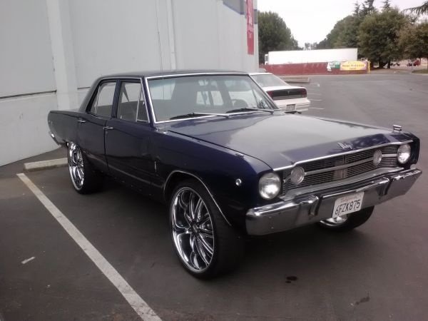

Not sure if this duster has actual 20s but I believe its a Hotchkiss built duster. If you can't resist adding modern sized wheels to a old car. This picture seemed to have the most taste I could come up with doing a search for 20s and duster.
I now know what the word "donk" mentioned above is thanks to this search. Geez.
I shall remove those images from my memory. Ugh.
Please no one do that to a Mopar till some of us older guys are dead and gone.
lol. Many horrid sights to come up with this one decent duster image. I pray donk is or was a short lived fad.
