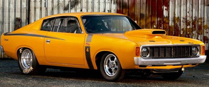

View attachment 1714986007 View attachment 1714986006 View attachment 1714986005 410ci na 1.31 60, 9.03@147mph, 5.71@120mph, foot brake
A8 block, 4.15borex3.80stroke, W9 heads, PAC springs, titanium valves, Jessel Rockers Kinsler stack injection, dry sump, Carrillo Rods, JE 15.1pistons, Bryant crank, 50mm Cam 268@50 780lift, Step headers 1 7/8 to 2 into 3.5
3000lbs Au Charger, 727 8in 5500stall, 9in 40spline 4.30gears, leafs, Caltracs, double adjustable Qa1shocks on the front Afco out back, anti roll bar, 29x12 tyres, 8 point cage
Working on suspension and should go a little quicker when hooked
Love that car. Color ect is excellent!
