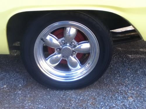

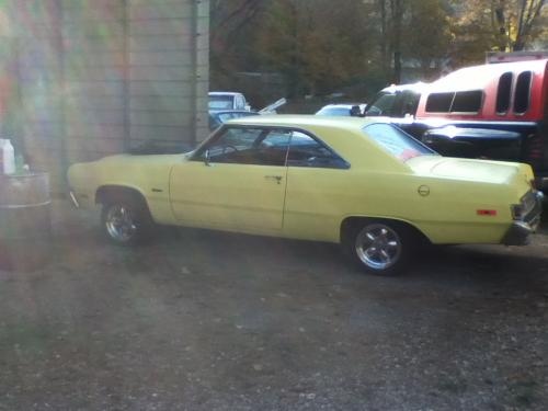

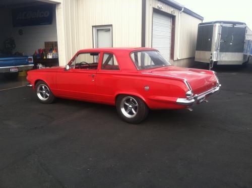

1974 Plymouth Scamp
Front
Wheel Brand American Racing
Size 15"x7"
Backspacing 3.75"
tire size 225/50R15
Suspension mods None
Rear
Size 15"x7"
Backspacing 3.75"
tire size 225/50R15
Suspension mod Air shocks

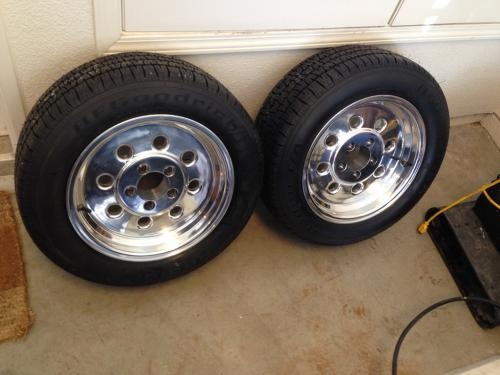

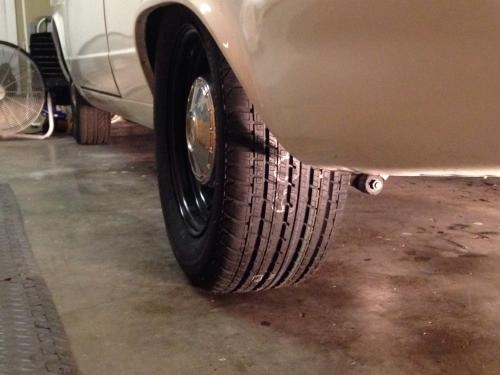

Just hung the new 8 3/4 under my Valiant. Running 15x7 steelies with 4.25" backspace. They ended up fitting great.

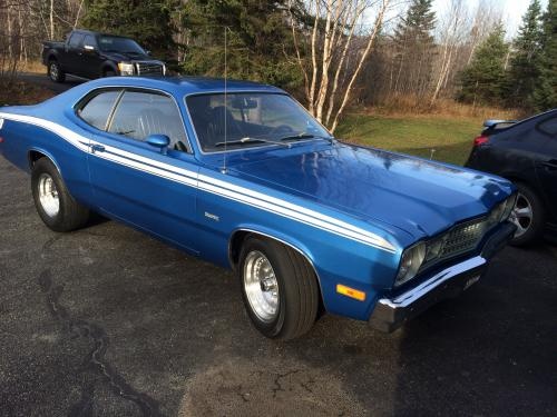

Looks like many of you are running a 275/60 /15 on a Duster with no mods, this is great news as I'm building a 72 Duster right now. I'm used to the Scamp and Darts that have less room for tires.
The Darts also look best when the tire is tucked inside the rear quarter lip but I'm noticing in all these photos that the Dusters really look good with big meats out to the edge of the quarter.
I don't want it to rub though if there's 2 adults and 2 teenagers in the car.

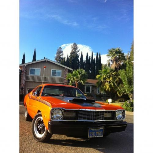

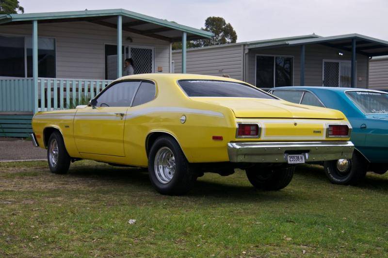

Front: 7x15" REV100 205/60/15 Michelin tyres
Back: 8x15" REV100+1" spacer 235/60/15 Nankang tyres

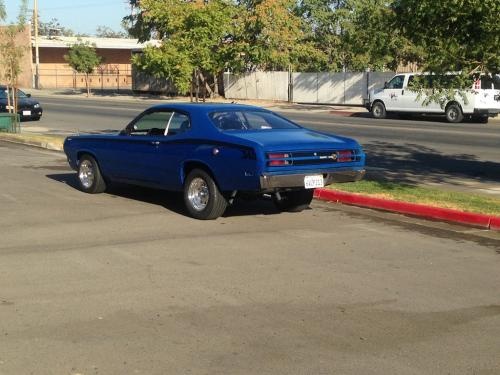

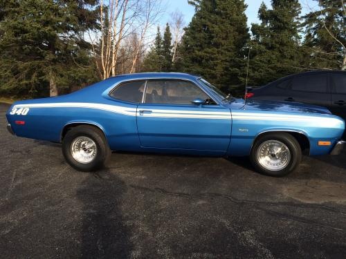

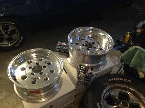

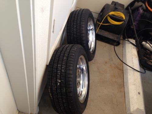

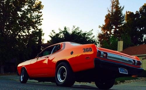

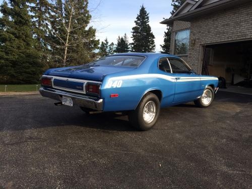

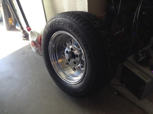

Here is my 71 Duster:
Front:
Tires: BFG T/A Radial 205/60R/15
Rims: Summit Quick 8 15x7 Rims on 5 x 4.50 bolt pattern, 4.00in B/S.
Mods:
- Right Stuff Brakes Manual Disc Brake Conversion, Mopar 5X4 1/2" Bolt
- Hotchkis 1.03 torsion bars
- Hotchkis Adjustable Strut rods
Rear:
Tires: BFG T/A Radial 245/60R/15
Rims: Summit Quick 8 15x8 Rims on 5 x 4.50 bolt pattern, 4.50in B/S
Mods:
- XHD +1 Leaf springs
- Calvert 9-way adjustable +1 Shocks
- Assasin Traction bars
- Dr. Diff Axle Pkg Stock Length Mopar 5X4 1/2" Bolt

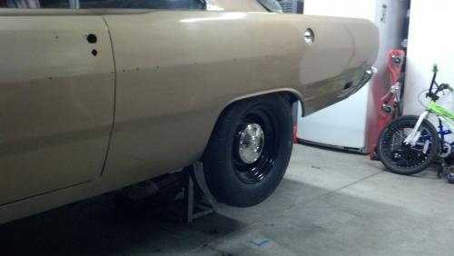

Hmmm, looks familiar. Mine is a 69 Dart with a 15x7...4.5" backspace.
