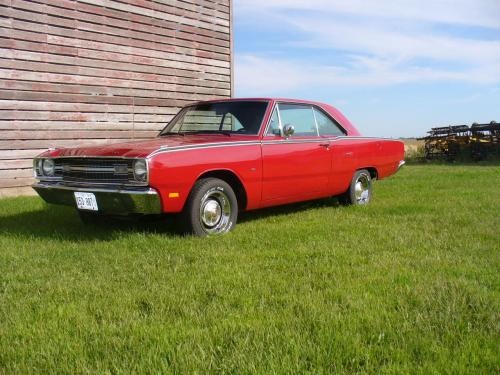

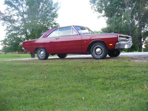

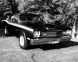

More pics! I'm in the process of putting all new suspension and brakes under my '64 dart, and am planning on throwing on some cop steelies I've got laying around on it! I'd really like to see some better pics of the entire car and see how I like the wheel and tire combo!
i only have my camera on my phone, apologies, and i just got her running again tonight, so these ones are in my shop, and theyre a bit dark. hopefuly they give you the ideas youre after.

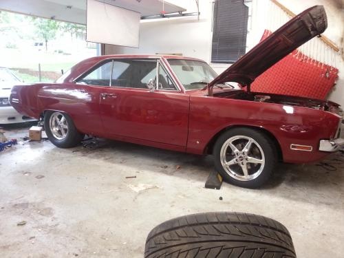

Finally got my new setup put on.
Race Star rims.
Fronts
Race Stars 17X4.5 1.75 BS with 26X6-17 M/T Sportsman S/R tires
SSBC disk convertion to 5X4.5" bolt pattern
Hemi torsions bars lowered are far as possible ( the front in the picture is not at ride hieght, car has not been moved yet so the suspension will still settle more once moved)
Addco front swar bar
Rears
Race Stars 15X8 5.25" BS with 275/60-15 Nitto 555DR's
Moser axles with 5x4.5" bolt patten drums lugs redrilled for larger pattern
7/32" wheel spacers
Offset spring hanger kit
Stock springs
Caltrac bars
Air shocks
Addco rear sway bar
