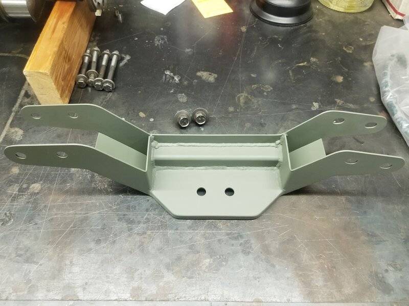

The torsion bar crossmember you have to cut and strap to get the O/D unit to clear however. I trimmed mine and left the flanges for the floor then bent steel and strapped the area I cut out. You can see this in the pic. Much easier to engineer this and weld it in when the floor is out of the car.Should be no cutting on the floor hump. I did end up dimpling mine though. I fit a 42RH during my floor replacement. Used a chevy truck trans mount. Heres how I did mine. I used a lot of ideas from junior 340 I moved the inboard bolt holes out, and left the outboard bolt holes intact.
